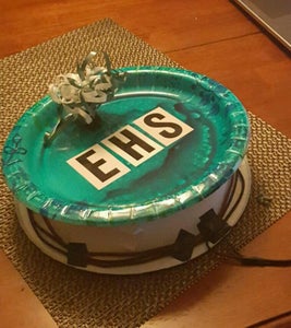

Materials:
3x Paper plates
1x sheet of paper
20" of 26 gage wire (found at radioshack)
1x hot glue gun
1x scary magnet of the neodymium kind
2x alligator clips
1x lighter

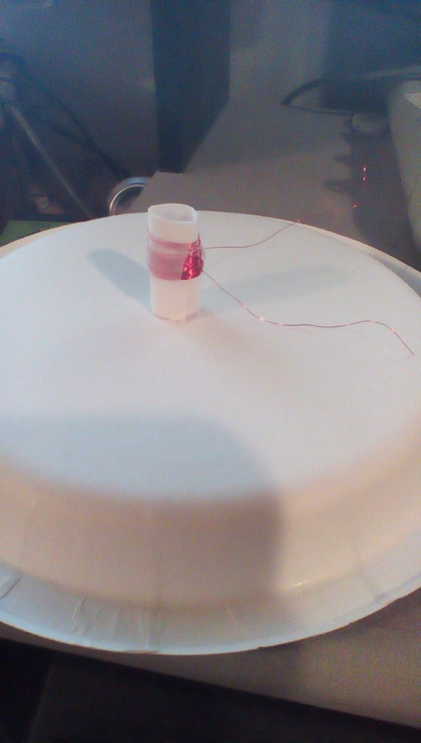

Step 1:
Cut two pieces of paper so that they’re about 3cm taller than the magnet. This does not have to be exact.
Step 2:
Wrap first piece of paper around magnet tightly then wrap the second piece of paper around the first.
Step 3:
Tape the second piece of paper so that it stays in a circle. Then, remove the first piece of paper. This will leave a very small amount of room between the magnet and the paper so that the paper can move.
Step 4:
Glue the magnet to the center of one of the paper plates.
Step 5:
Glue the circle of paper to the center of the second paper plate
Step 6:
Wrap the wire very tightly around the circle of paper. Leave approximately 10 cm of wire from each end hanging loose off of the coil.
Step 7:
Cut a 13cm by 10cm rectangle out of the third paper plate.
Step 8:
Fold the rectangle accordion style so that the folds are parallel with the 10cm side. Cut it in half the long way so there are two 13cm by 5cm accordion folded rectangles.
Step 9:
Glue the ends of the accordion pieces to the paper plates. Glue them so that the faces of the rectangles are facing towards the magnet and coil. Glue them about 5cm away from the magnet on opposite sides from each other.
Step 10:
Burn the enamel off the ends of the wire hanging off of the coil.
Step 11:
Attach the audio jack to the ends of the coil using alligator clips. DO NOT attach anything to the white wire on the audio jack. It is useless. It does not matter which end of the coil is attached to which wire on the audio jack.
Step 12: Easy Mistake
Creating a speaker requires many steps, and it is easy to make mistakes. One mistake that is easy to make can happen when hooking up the audio jack to the coil. The white wire on the audio jack is useless to this project and doesn't need to be used at all. Placing one of the audio jacks on this wire will cause the speaker not to work. One easy way to avoid this problem is by simply cutting the white wire off, that way there is no need to worry about putting anything on it by accident. Also, make sure all of the contact in your jack are properly attached to the jack so that it works, and you don't spend hours trying to figure out what is wrong with your coil even though its a jack issue.
