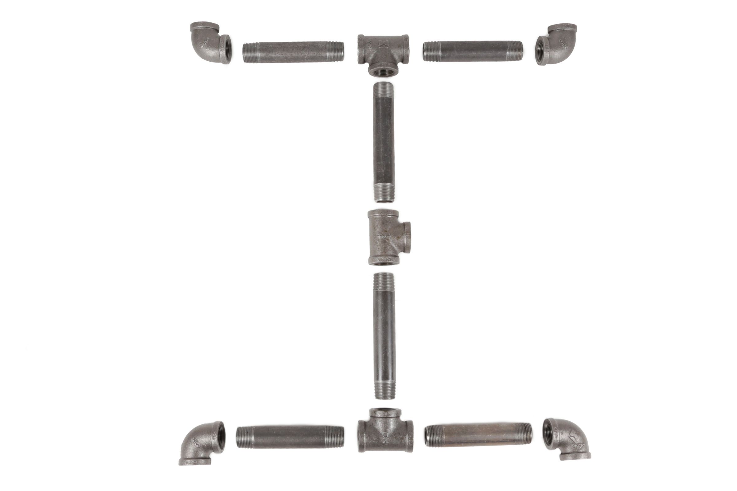

For the base:
(x3) 3/4" T-connector
(x4) 3/4" L-connectors
(x2) 6" pipe
(x4) 5" pipe

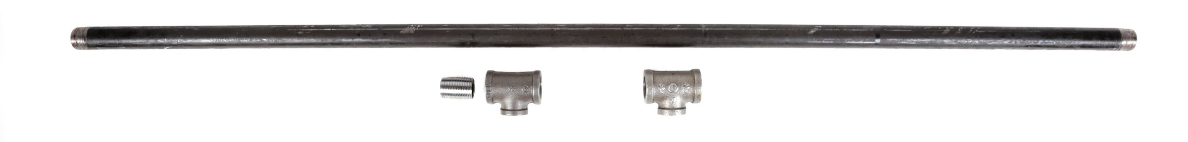

For the center column:
(x2) 3/4" - 1/2" T-connector (where the base of the T is 1/2")
(x1) 3/4" threaded coupling
(x1) 3/4" x 4' threaded pipe

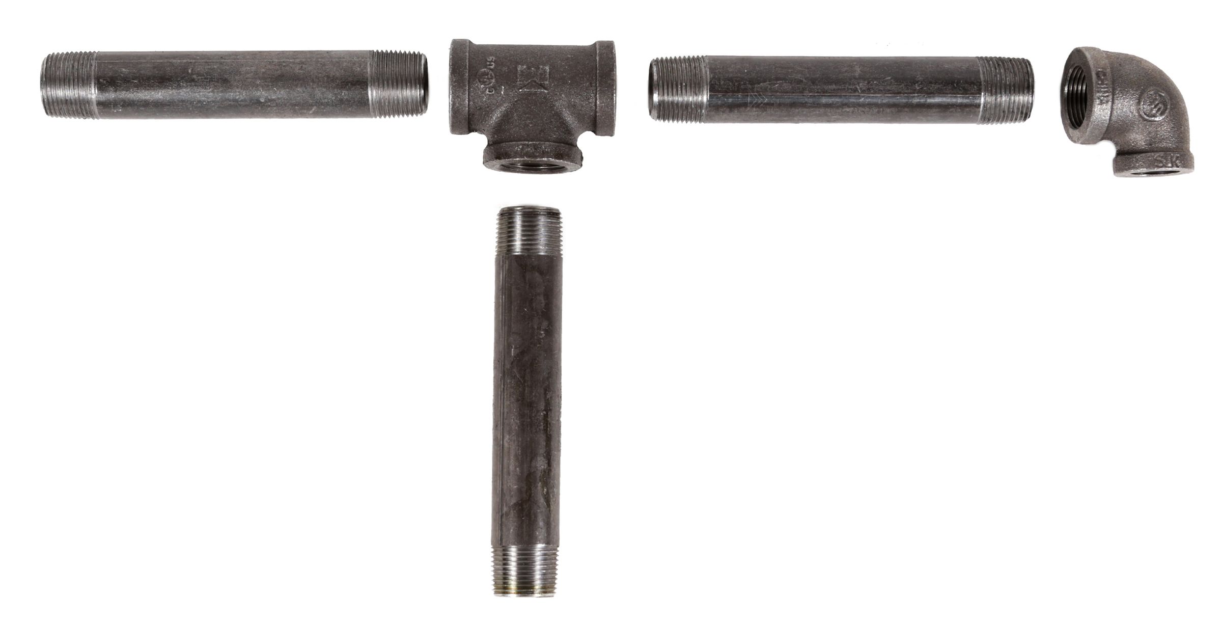

(x1) 3/4" T-connector
(x1) 3/4" - 1/2" L-connector
(x3) 3/4" x 6" pipes

To begin, I simply twisted all of the pipes and fittings for each section together. However, I did not yet connect the sections to one another because that would have made it near impossible to thread the power cord through.
