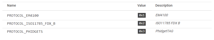

You will notice that the data you get back will look something like this
('5f00dbc416', 1)
The reason is that the getLastTag function returns a tuple, the first parameter being the data from the tag and the second being the protocol used. You can look at the image above from the API to help you decode what protocol your tag is using. You can see the tag I read had the data '5f00dbc416' and was using the EM4100 protocol.
Step 4: Protocols
The main difference between the protocols used actually relates to the certification that they have, the frequency that they transmit on, and how the data is encoded. Data written using the EM4100 protocol must be in hexadecimal format. If you are using ISO11785 FDX B then the data will be written in decimal format. Finally, the Phidget Tag Protocol allows you to write data in plain text.
For this tutorial, it really doesn't matter which one is used, as the RFID Phidget will look for all three variants, but my card happens to be using the EM4100 protocol so that is what will be demonstrated going forward.
