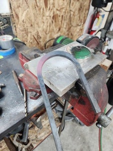

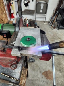

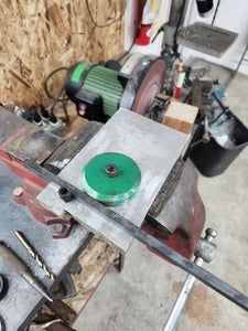

I had to make a rudimentary iron bender for the curve so I drilled two 3/8" holes in the plate and one in the metal disc.
As you can see from the picture, one to hold the disc (mandrel) one to keep the bar in place. I could of made it fancier with a arm to bend the metal, but since I had the torch to heat the metal I figured I would try to keep it simple.
Step 2: Bend the 180
I'm sure with a bigger/better bender I wouldn't of had to use heat to make this bend but since I had the torch it made it pretty easy. Cut a piece of material to what I thought the length would be, set it in my bender heated and went for it.

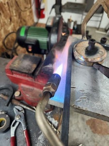

Step 3: Twist the Iron
I had to do something kind of fancy to make these look a little better so I decided to put a couple of twists in the bar. This picture is probably the 5th attempt to get this correct. A little trial and error and I got the bend I wanted and it kept the bar straight. The first attempts the bar got twisted over and crooked. Turns out it's all technique - how to twist and where to heat. Using two wrenches and keeping my movements centered on the bar (vs one wrench and twisting it crooked) I got the results I was looking for.
The first picture had my first attempt at this (to the right) Everything was kind of wonky.

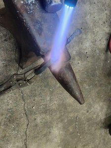

Step 4: Flatten the Ends
I didn't get these the way I envisioned but I'm happy with the results. I'm sure with a press or power hammer - like on forged in fire - It would of been better.
I had to reheat the piece a couple of times and be careful with my hammering. A mini forge would of made this easier but I got it done with just using the torch.

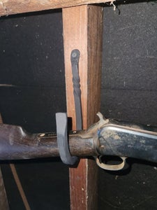

Step 6: Finished
I realized I need to put a felt strip inside of the hanger so whatever is in there doesn't get scratched up. Went back and check and realized that's very common in all of the other hangers and racks.
I got the 'rustic' look with these not because I was trying to - but its the way it turned out.
