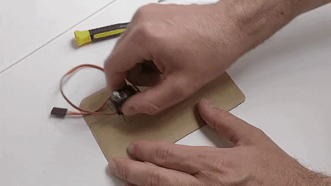

Making connections
As a main method of making connections within cardboard elements we suggest using screwdriver for making punctures and then twisting it with nut and bolt. This method provides strong and rigid connection, is very easy to make even for small kids with some practice, you can disassemble the connection and fix it easily. Also nuts and bolts are endlessly reusable.
PRO TIP — for some quick prototyping and testing you do not even have to screw the nut on the bolt. The bolt thread will keep the cardboard connected for a while.
Cutting holes
Puncture the cardboard in four corners of the rectangle hole you want to make, this will give you a tracing points for scissors cuts on both sides of the cardboard sheet.

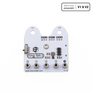

3. Micro:Bit adapter
The only limitation of Micro:Bit is that you need some kind of adapter to connect motors and provide power supply. For the sake of simplicity we suggest using adapter listed below:
Elecfreaks ring:bit V2 (suggested)
If you have basic electronic experience you can workaround and connect servo motors to Micro:Bit without the adapter, or make this kind of board on your own.
Other adapters
There is of course a huge choice of more capable Micro:Bit adapters with much more features. For the sake of simplicity we suggest only basic solutions with micro servo and we find smaller adapters with less features more suitable for basic school needs. To go on with any other adapters or Micro:Bit extensions you will have to make some modifications in our robot designs,
