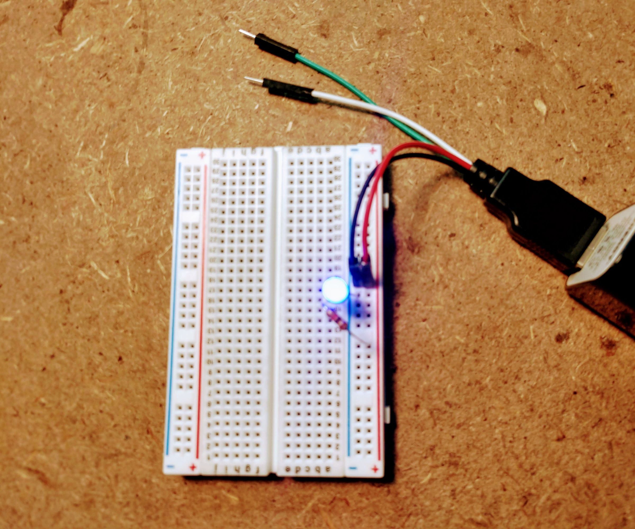

Step 7: Finished Product Ready for Testing!
Insert the coin cell (+ side up) and now you are done. Align the right jumper pin with the right end of the LED and you can test if it works. Now you can test them at will, demonstrating the full power of this battle station! I mean tester, getting ahead of myself again. Sorry.
