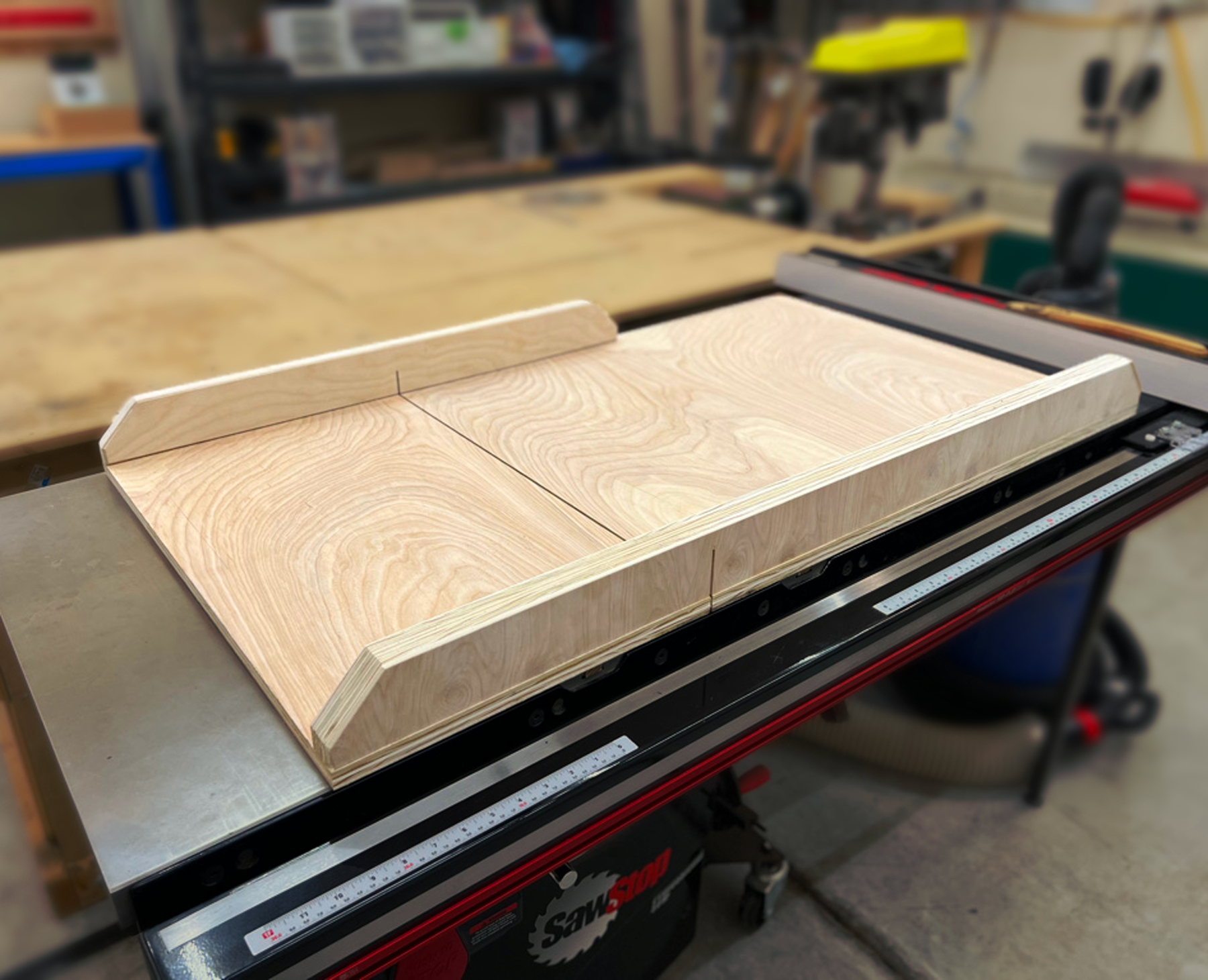

Next you're going to cut out the legs, stretchers, and sides. Set the saw at 4" to cut the wider stretchers and legs. These pieces will meet against another 3 1/4" inch piece that'll create a nice 4" square leg assembly. Move the fence to 3 1/4" and cut the remaining pieces. Mark out the pieces to their final length before cutting them at the crosscut sled.
For the center stretchers, cut those as one single piece. Since this will require repeat cuts, set up a stop block on the crosscut sled to give more accuracy. This allows for any errors to be continued through the entire build and if you're a little off here it'll be off consistently on every piece.
