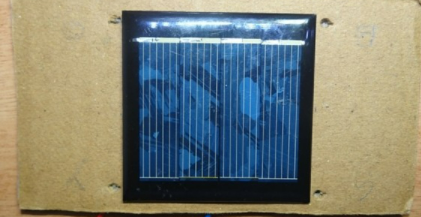

Step-1 First, you have to take a cardboard and make a hole in the middle and four holes on four sides to fit LDR into that. Then stick the solar panel to the cardboard and bring two wires of the panel out as shown in the picture.

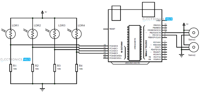

Step 3 Solder the two leads of LDR as shown and to the other ends of LDR solder resistors of 10k ohm. Connect the 4 LDRs with a wire.

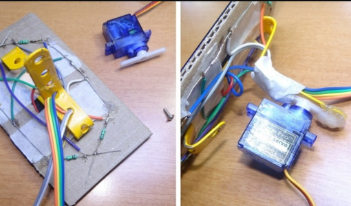

Step-4 Now you have to take a bus wire. This will help to connect the outputs of four LDRs to the Arduino board. Now insert it into the metal strip as shown in the picture. Now you have to solder the four wires to four LDRs between LDR and resistor.
Step 5 You have to insert another two-wire bus into the perforated metal strip for supplying Vcc and GND to the LDR circuit one wire leads to the LDRs which are connected to resistors and the other wires to the other leads. You have to shorten the leads of LDRs connected to resistors using a wire as shown in the picture.

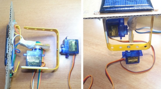

Step 6 Now comes the motor part. You have to connect a servo motor to the perforated metal strip. Apply glue to the servo to keep it in place. Take another straight perforated metal strip and bend it.
Step-7 Now the last part. Place the set up of solar panel and first servo motor to the metal strip of the second servo motor as shown in the picture. And you are all done.
