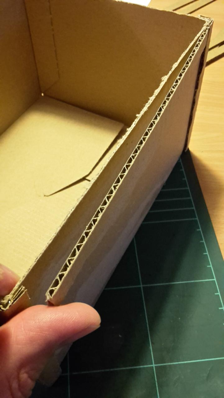

Step 2: Step 2 - “Iron” Edges
I decided to simulate iron edges with raised cardboard which would look good. I left the bottom free as my box was very stable by itself. The “iron” edges would be 10 mm wide all around and 3mm thick which seemed about right for my box size. The width should fit the look on some real chests so feel free to choose a width that fits your version.
Note: it looks good when all edges are equal in size. Also you could use non-corrugated cardboard for the “iron” edges or even just paint the edges… Your choice :-D
Mark and cut some sections for the horizontal edges: 4 long and 4 short edges on the basic box itself and 2 long edges on the chest lid. Make them a bit longer than needed so you can fit them later. The ends of the lid were made from single pieces, so I didn’t count the short ones for the lid.
Careful measurement, marking and cutting should yield a nice even width on all pieces and don’t forget to cut across the corrugations to avoid collapsing strips (and it looks good).
For the vertical edges I decided to fold the cardboard around the edges and therefore needed wider strips as I didn’t want the corrugations to be visible on the ridge itself. Now apply a minimum amount of math to the project: Add the two sides with half the thickness of the cardboard to allow for bending without losing the width of the edge: 10+10+1.5 = 21.5 cm (width + width + half thickness of cardboard). Again cut them longer than needed to allow for fitting.
Mark the centerline of the wider strips and press something with a hard edge down the middle of it. A ruler is fine for this, but anything with a straight edge should do such as a wooden chess box. This compresses the cardboard corrugations and makes it easy to fold along the compressed lines.
Note: Some of my compressions were slightly off and had to be adjusted by pressing the right places to get it right. If I needed to make further adjustments or had made the folds non-parallel I would have to make new ones.

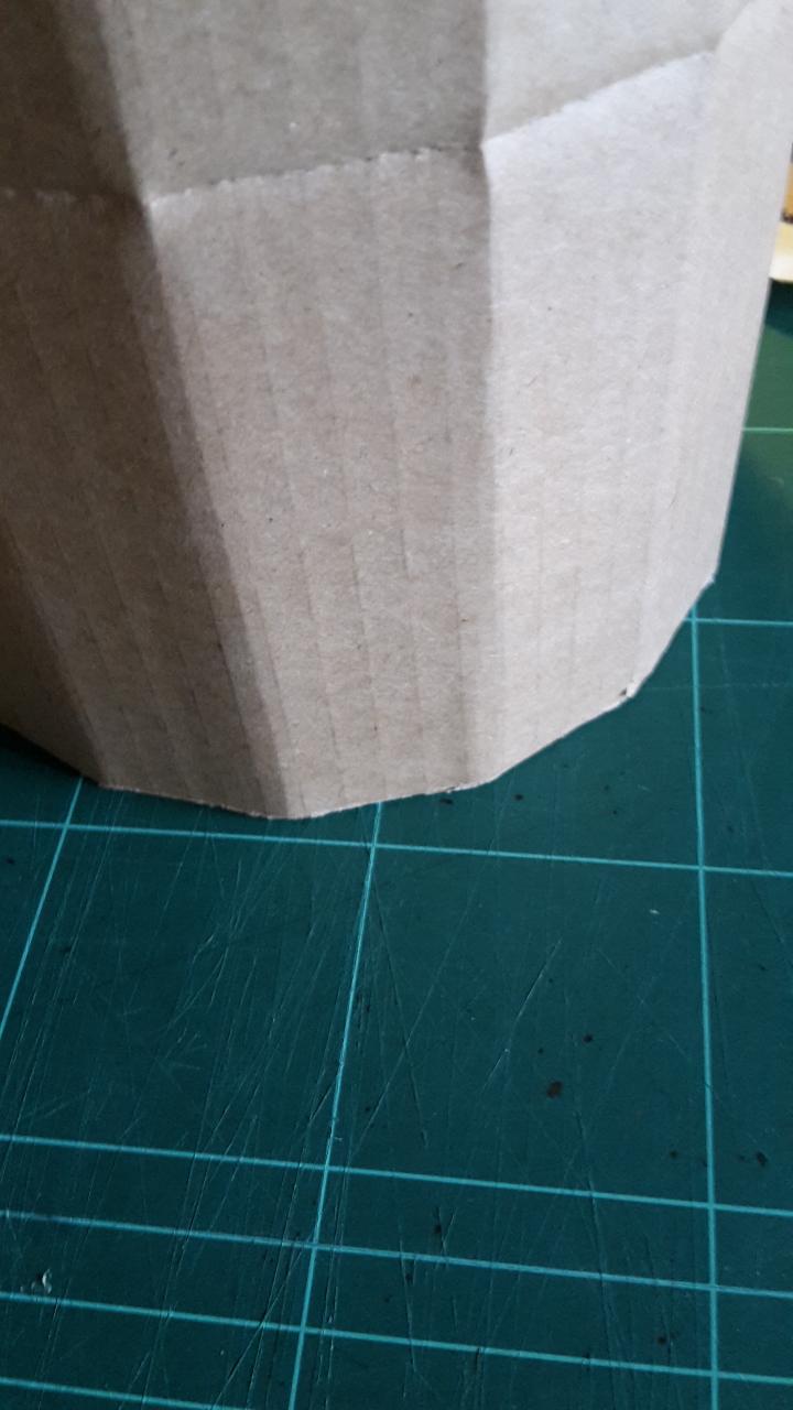

Step 5: Step 5 - the Basic Lid Structure
Up until now things have been pretty much straightforward except for the hinges perhaps, but this is the lid which is perhaps the most prominent feature so we want his to look good and fit perfectly onto the box/chest. Dry fit to make sure you are on track as you go along.
Measure the width of the top of the box on the outside but on the inside of the “iron” edges. At this point this should be easy to see from above. It could be measured before any “iron” edges are applied, but the hot glue and “iron” edges could warp the cardboard box a little bit, so now is fine (besides I forgot to measure beforehand).
Make half a circle on a 1 mm cardboard piece for each end using the measurements. Mark them to be sure which end is which. Cut both pieces out and that’s basically the shape of the lid… Come to think about it I chose the 1 mm because I ran out of pieces of 3 mm. You can easily use the 3 mm board here just like it is on the box.
Aaand it’s time for math again. I decided to make the lid simulate 7 “planks”, but you can make as many as you want. 1 “plank” will give you a flat top, 2 will become a triangular shape, and 3 will give you a resemblance of a curve. Therefore I suggest at least 3 but it depends on what looks right on your version (You could even bend it in so many places that there won’t be any “planks” visible). Calculate the circumference on one of the half circles:
Circumference = 2*π*radius or Circumference = π*diameter
Divide by 2 to get the circumference on the half circle.
In my case the diameter was 14 cm which gave the half circle a circumference of 22.1 cm (rounded off). This would give the 7 “planks” a width of slightly above 3 cm. I chose 3 cm wide “planks” and divided the remaining 1.1 cm into two thin “planks” that would be vertical. In essence this would actually mean that there would be 9 “planks”, but 2 would be hidden. The bent corrugated cardboard is 22.1 cm long and as wide as the inside of the box. Of course your calculations would yield a different result, so choose a width of the “planks” that allows for the 2 minor vertical “planks”. It doesn’t even have to be an even number.
Note: You can see on my lid how I had to use part of a lid along with one side to get a piece big enough. The creases would have to be covered.
Once you have cut out the plate as perpendicular as possible you make the marks for the “planks” and press a ruler down to make the bends as before. Make sure that the marks are centered so both end sections have the same width. When you have an uneven number of “planks” you want to make the middle one parallel with the bottom edge in the middle of the half circle. If you decided on an even number of “planks” the middle bend will have to be above the center of the chest at the apex of the half circle.
Place one of the half circle ends on your flat surface and put the bended “planks” vertically on top of that and make the outside bends of the middle “plank” touch the outside of the half circle parallel to the edge in the middle of the half circle. Apply hot glue to the topmost part on the inside only and let it set while holding it in place. Once set you simply make the next bend touch the half circle and hot glue on the inside and go on until you reach the bottom edge. Do the same for the other side. Don’t hot glue on the outside as this will be covered by the “iron” edge.
Now flip it over and place the other half circle on your flat surface. The “planks” are now hot glued on the inside to the end plate just like the other end. Check that the lid structure fits your box top and make adjustments if necessary. Cut away the material that exceeds the “planks” and you have your lid base structure complete.
