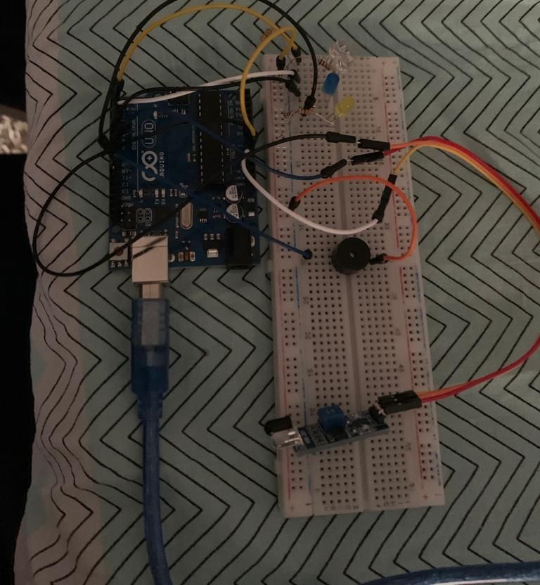

Step 1: Insert the Basic Stuff
Put the breadboard on the ground and put the Ultrasonic sensor on the Breadboard. For example, put it on pins 30a,31a,32a and 33a.
Step 2: Wiring
Attach as following:
  • GND to GND
  • VCC to 5v
  • Trig to pin 8
  • Echo to pin7
