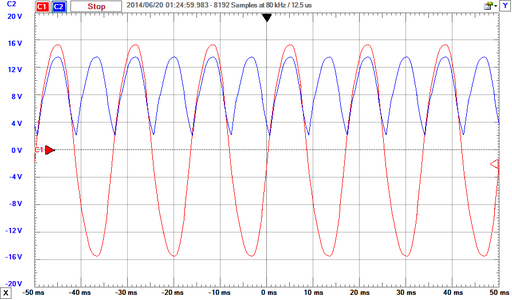

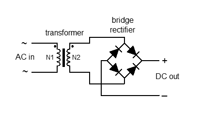

The transformer should output about 12VAC. The LEDs I bought are rated for 12VDC. In order to convert AC to DC, the AC needs to be rectified using diodes. But LEDs are diodes (Light Emitting Diodes), so technically this circuit will work fine without even using the bridge rectifier. Just plug the LEDs to the transformer output and away we go. The problem is that the LEDs will flash about 50-60 times per second with each rise of the AC sine wave. When the AC voltage goes negative, the LEDs will turn off because that's how diodes work. You only get power through a diode in one direction not both. So they are flashing 50 times per second, but they aren't even on for the entire flash period, maybe about 40% or so. The point is that you will notice the flashing. The bridge rectifier makes all of the negative AC voltages turn positive, so the flashing is twice as fast and the lights are on for more time (as a percentage) per flash period. You can see the difference in the o-scope readout in image 2. The red line shows the full 12VAC wave going positive and negative. The blue line has been rectified so the voltage is always positive. If we wanted to fully convert to DC voltage, we would add a 470uF electrolytic capacitor across the DC output and then feed that signal into a voltage regulator. The output from that is a very clean and stable DC voltage. I used that design in this Instructable.
One thing to note with this project is that the power supply is unregulated, so any fluctuations in the grid will get sent straight to the LEDs. I don't expect them to survive a large spike, but it only cost me about $3 for the whole project, so I'm not really worried about it.
