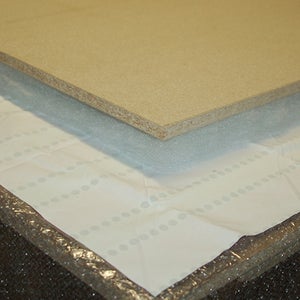

Step 1: Get Everything Ready
1. Measure the fabric so that it is 10cm on all sides. This is especially important if you are using a fabric that frays easily.
2. Cover your work surface to prevent damaging the fabric. Place the fabric face down, place a double layer of batting on top of this and then put the board on top of this. Make sure that the batting and board are lined up and that both are equally placed on the fabric.
3. Cut out a 5cm x 5cm square at each corner. This will prevent the fabric from being bulky when folding over the corners.
4. Use your fingers to tease the top layer of batting out from the edge all the way around. This will soften the hard edges when wrapping the board with fabric.
