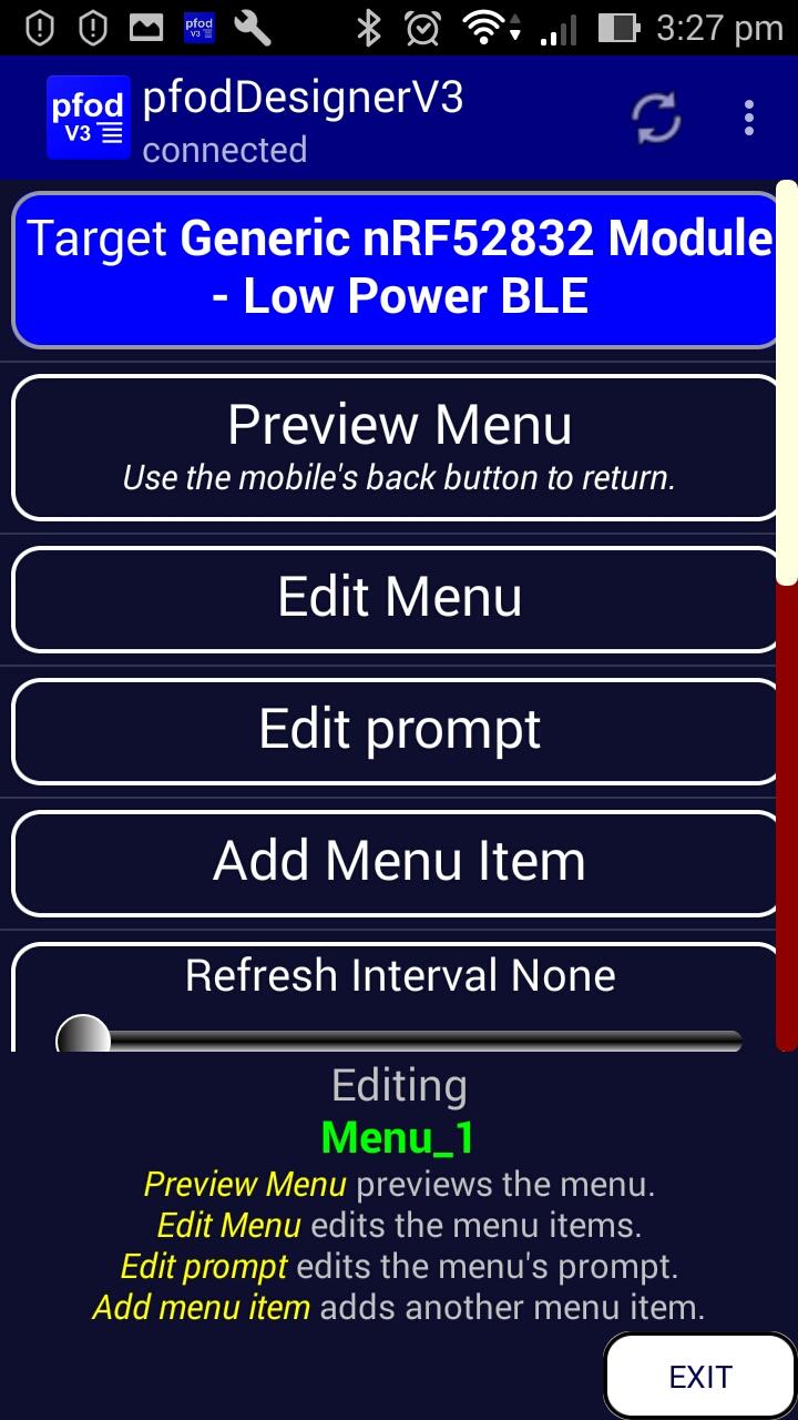

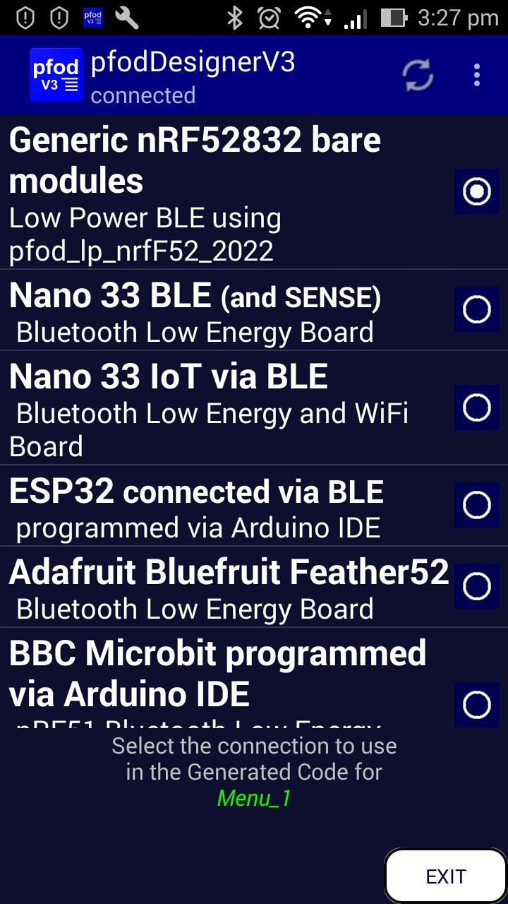

Wire up the programmer, install the low power support and use the free pfodDesigner to create a custom control menu/data logger and generate the low power sketch for pfodApp to connect to and display the controls and chart and log the data.

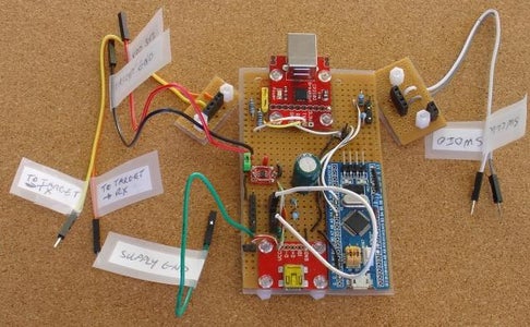

Step 3: A Minimal NRF52832 CMSIS-DAP Program / Serial Debug Module

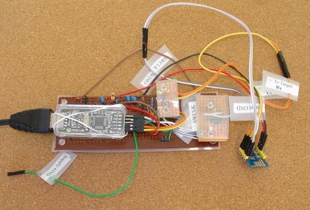

The DAPLink programmer is the most reliable (See Help My Upload Failed below). It is less sensitive to the size of the protection resistors in the SWCLK and SWDIO lines.

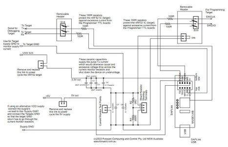

This minimal programmer has 100R resistors in the SWCLK, SWDIO, RX and TX lines to protect against plugging in to the wrong pins. There is no protection on the 3v3 and Gnd lines. You just have to be careful and double check. Remember “one flash and its ash
The Raspberry Pi Pico programmer is similar with 100 ohm protection resistors added.
Step 4: A More Extensive Programmer / Current Monitor Board
Note: The Online Nordic Power Profiler does a good job of estimating the current under varying conditions. But this current monitor is still necessary to check for un-expected current usage.
(See the parts list at the top of this Instructable)

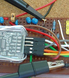

In this circuit (pdf version), the 3 x 22uF are used to supply the chip's Tx current pulses. Otherwise the voltage drop across the current monitor resistors will cause the nRF52832 to shut down. The oscilloscope monitoring the current is connected between Target GND and Supply GND.
A small header board is used to connect the SWCLK and SWDIO leads and at the same time short out the Current Monitor Resistors so that programming, which draws more current, does not fail on low voltage. There is also another header for the Tx and Rx for the Arduino Serial Debugging connection. The SWCLK, SWDIO, Tx and Rx leads all have 100R resistors in series to protect against miss wiring to the nRF52832 pins. The 100R resistors limit the maximum current that flow via the in-chip I/O protection diodes to 33mA.
Regardless whether you use the 3V3 lead or another external supply to power the nRF52832, the negative (GND) return from the nRF52832 should be connected to the Target GND lead so that the return current will flow through the current monitoring resistors. If using and external supply, connect its -ve lead NOT to the nRF52832, but to the Supply GND lead.

If you don't want to use pfodApp, you can still use the pfodDesigner to design a menu and then program the menu cmds into UART control in Nordic's nRF Toolbox. This project also uses Nordic's nRF UART v2.0 app for testing.

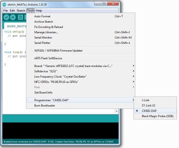

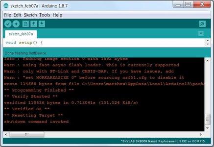

Open the Tools → Board and scroll down to find the pfod low power nRF52832 boards
Note: the boards with * against them do not use the selected Programmer. Instead they use their own pre-configured programmer.
Here we are using the *Generic nRF52832 bare modules via DAPLink as the programmer.

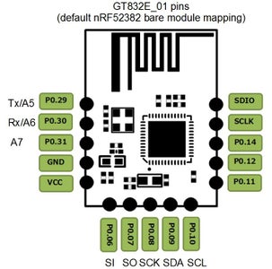

There are many different 'bare' nRF52832 modules available and they expose different uC pins, and different numbers of pins, to the pcb edge connections. So to handle all of these possible configurations the *Generic nRF52832 boards just maps the nRF52832 uC pins to Arduino I/O, one to one. That is uC pin P0.00 is Arduino pin 0, P0.01 is pin 1 etc. You just need to use the pins you can access from the pcb connections. A0 to A7 are defined as the AIN pin numbers. D0 to D31 are not defined. Instead of D0 to D31 just use integers 0 to 31 for the digital I/O pin numbers. (Pin Mapping pdf version)

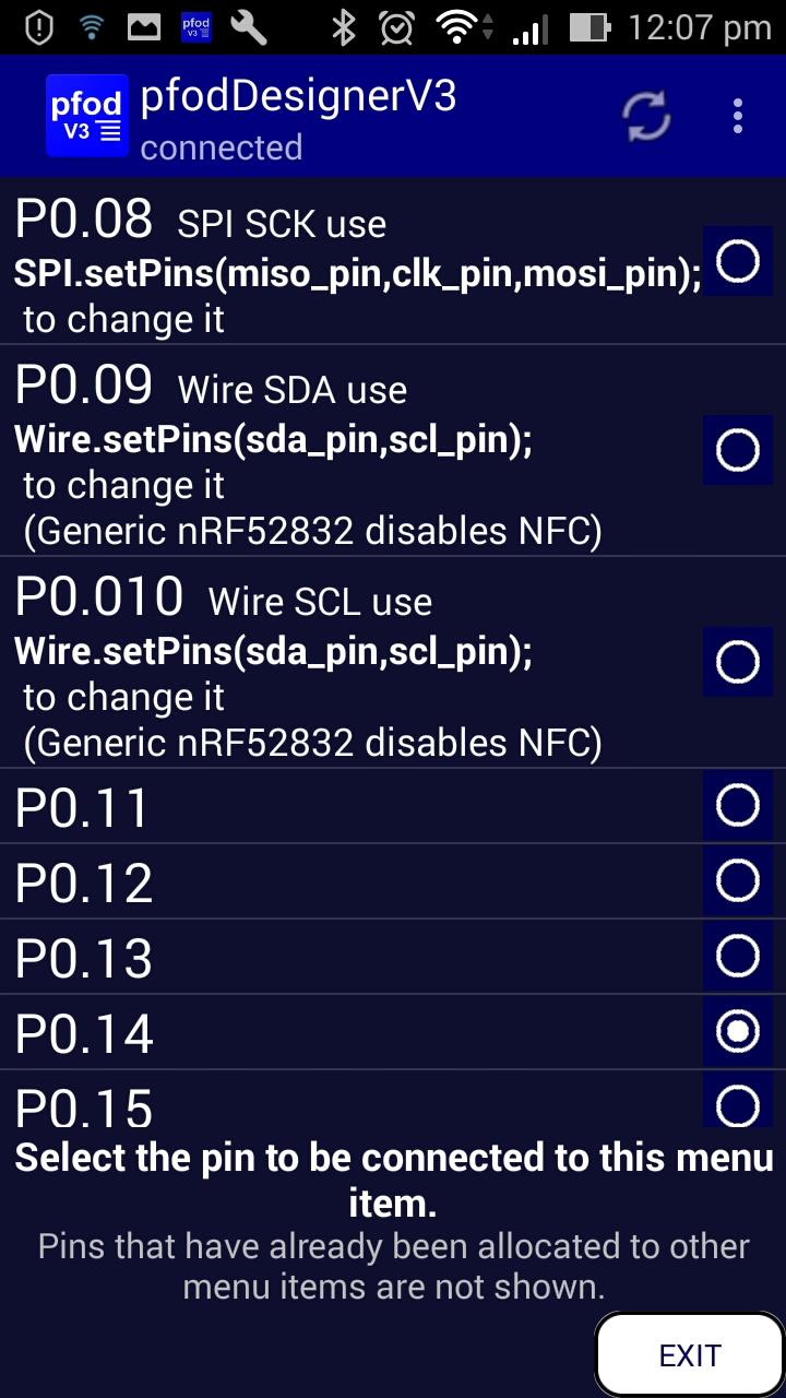

By default Serial Tx,Rx are pins 29 (P0.29) and 30 (P0.30). While Wire SDA and SCL are defaulted to pins 9 (P0.09) and 10 (P0.10) and SPI MOSI, MISO and SCK default to 6 (P0.06), 7 (P0.07) and 8 (P0.08). SPI SS is not defined and is not needed for SPI master mode. You can use any I/O pin to control the chip select (CS / SS) of the connected SPI device.
If these default pins settings are not convenient or not available on your module, you can override them with:- Serial.setPins(rx_pin,tx_pin);
SPI.setPins(miso_pin,clk_pin,mosi_pin);
Wire.setPins(sda_pin,scl_pin);
Call these methods before call the respective begin() methods.
Pins near Radio Power Supply and Antenna Pins
The following pins P0.22. P0.23 .. through to P0.30 should be limited to low drive (standard, see High Drive Output Modes below), low frequency (<10kHz) I/O only. That would limit Serial on P0.29/P0.30 to 9600 baud, but for testing/development 115200 works. Since the UART uses significant supply current, you will not normally have it enabled in the final device. However if you do use Serial, either use 9600baud or use Serial.setPins to use another pair of pins.

In the *Generic nRF52832 boards, the NFC pins are re-assigned as GPIO pins for general I/O. NFC (Near Field Communication) support is not included in this package.
The pins dedicated to the NFC antenna function (P0.09/P0.10) have increase leakage current (typically 2uA, max 10uA) between the two pins when they are used in GPIO mode, and are driven to different logical values. To save power the two pins should always be set to the same logical value whenever entering one of the device power saving modes. The Wire Stop condition sets both these pins high so no excess current is drawn when Wire is not reading/writing. You can use different pins for the Wire interface by calling
before calling
Wire.begin();

In this tutorial the GT832E_01 bare nRF52832 module is being used. This module has the advantage of 0.1” pcb pin spacing so you can attach headers to the pcb for easy connections. (GT832E_01 pins pdf version)
Connect the VDD 3.3V and Target GND leads and the SWCLK and SWDIO leads connected to the GT832E_01 module. When the SWCLK/SWDIO header is plugged in the current monitor shunt resistors are shorted out to allow programming to succeed without causing low chip volts.

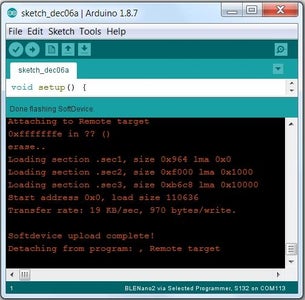

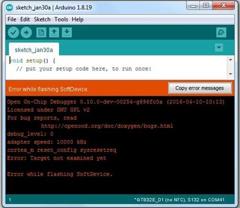

On Windows 10 (and 7), programming the nRF52832 can be a bit hit and miss.
NOTE: When using a CMSIS-DAP programmer, even though the COM port shows up, you may need to run the OpenOCD as described below each time you plug the programmer in, to force it to be recognised fully.
The DAPLink programmer does not seem to have this problem on Windows 10 and 7.
If the Upload of your Arduino sketch fails try these steps.
Check the wiring to the nRF52832. Wires on the correct pins and tight connections.
Plug the USB programmer into the computer.
If the Arduino IDE programming (or load of softdevice fails), try it again
If still fails
Open a cmd prompt, run as admininstrator, and cd to the OpenOCD dir
and and keep trying the cmd
bin\openocd -f interface/cmsis-dap.cfg -f target/nrf52.cfg -c "telnet_port pipe;tcl_port disabled;gdb_port disabled;log_output
until you get the line Info : Listening on port 3333 for gdb connections and the program is still running.
This can take 2 or 3 attempts
If using a CMSIS-DAP programmer and multiple attempts of this cmd fail, try using straight through connections without the 100 ohm protection resistors, checking the connections carefully. The DAPLink programming module is detected much more reliably.
The above cmd pipes the input from the current cmd terminal so you can just type the following command line to check the connection.
reset init
One user had problems with transferring from the programmer to battery operation. This does appears to be an atypical problem. However he solved this by powering the nRF52832 from the battery while programming. That is by only connecting the GND, SWCLK and SWDIO wires from the programmer. The 100 ohm series resistors in the SWCLK/SWDIO lines limit the current due to slight differences in the programmers 3V3 supply and the battery voltage.
Programming the Nordic Softdevice -- No necessary with pfod_lp_nrf52_2024
With pfod_lp_nrf52_2024 the softdevice is automatically programmed each time you upload a sketch.

Step 9: Measuring the Supply Current
Having programmed the nRF52832_basic_blink.ino sketch, lets measure the supply current.
To measure the supply current
1) Upload the nRF52832_basic_blink.ino sketch onto the GT832E_01, via the SWCLK/SWDIO header. With this header plugged in the current monitoring resistors are shorted out allow programming to succeed. Do not connect the Tx/Rx leads to the GT832E_01 target.
2) Remove the USB 5V supply supplying the GT832E_01 via the 3v3 regulator to reset the nRF52832 after the programming is finished. This is necessary in order to measure the correct supply current.
3) Move the current shunt shorting link so that it shorts out the 1K5 resistor leaving only the 330R resistor in the ground line. For very low current measurements just remove the link completely
4) Remove SWCLK/SWDIO header. Important: Leave this header inserted when power cycling the nRF52 after programming to ensure it starts up correctly. The nRF52 draws ~20mA for ~20ms on startup. Important: Remove this SWCLK/SWDIO header after the nRF52 starts up as it draws ~100uA. Also remove the Serial Tx/Rx header if connected.
Connection your multimeter, set to Hz, to pins 14 and GND should read 10Hz
Sometimes Arduino looses connection to the programming COM port. In that case try unplugging the programmer USB cable from the computer and plug it in again. If that does not work, close the Arduino IDE and restart it.
For the nRF52832_basic_blink.ino, sketch the supply current is about 5mA (with no led connected between P0.14 and GND). The voltage measured across the 330R current shunt resistor is ~1.52V. The voltage measured across the 300R current shunt resistor is ~1.52V, So the supply current is
1.52 Volts / 30 ohms == 0.005 Amps (i.e. 5mA)
If the supply is much higher this, there not enough voltage left to power the chip. This sets the upper limit on the supply current that can be measured with a 300R shunt resistor.
NOTE: If the voltmeter reads 2.6V across the current measuring resistors than the nRF52 chip is not running, but is stuck in start up due to insufficient supply current.

Measuring the supply current for this sketch using the 2K2 + 300R == 2K5, i.e. with the shunt link completely removed, gives meter readings of about 22mV, which implies an average supply current of 9uA (0.022V / 2500 ohms) = 0.009mA
So using sleep() and the lp_timer() has reduce the supply current from ~6mA to ~0.009mA (with no led attached)

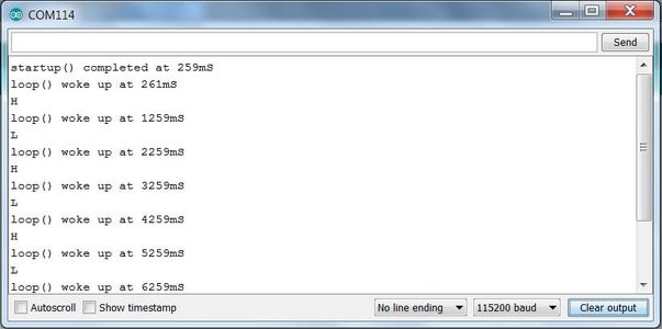

For debugging you can use the usual Arduino Serial prints. The low power sketches shown here generally don't use Serial except for debugging, because the Arduino Serial connection uses noticeably more power.
The Generic nRF52832 board defaults to P0.29 and P0.30 as the Serial Tx, Rx , but you can override that in your sketch using Serial.setPins(rx_pin,tx_pin); before calling Serial.begin();
void setup() {
Serial.setPins(11,12); // remap Rx to P0.11 and Tx to P0.12
Serial.begin(115200);
The Blink_lp_timer_debug_GT832E_01.ino sketch does that to remap Serial Tx to P0.12 and Serial Rx to P0.11 Plug in the Tx/Rx header and connecting “to Target Tx” lead to P0.12 and the “to Target Rx” lead to P0.11 lets you display the Serial output on your computer
There is some sample output from Blink_lp_timer_debug_GT832E_01.ino
startup() completed at 1ms
loop() woke up at 4ms
H
loop() woke up at 51ms
L
loop() woke up at 101ms
H
loop() woke up at 151ms
L
loop() woke up at 201ms
H
loop() woke up at 251ms
L
loop() woke up at 302ms
H
It is important to remember that the loop() is woken up by triggers other then the one you explicitly code in your sketch. The handleLedTimer is called from sleep() just before waking up the loop().

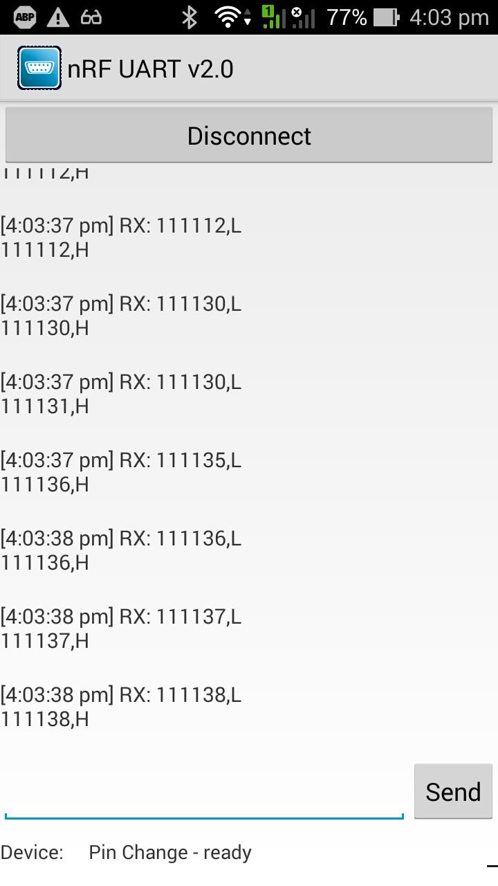

When the sleep() is triggered to wake up, the loop() checks if there is a new command from the BLE connection and starts/stops the blinking. Note: the sleep() is triggered to wake up by multiple things, the timer, BLE connection, disconnection, receive data, etc, so you need to check if any data has been received.
The Nordic's nRF UART v2.0 app is used to test this connection. After connecting you can send a or b to start or stop the blinking.
With the blinking off, the oscilloscope reads, across the 2K5 shunt, ~163mV (avg) advertising and ~148mV (avg) connected. No Led connected. That is ~65uA advertising and ~59uA connected.
Important: Remove the SWCLK/SWDIO header after the nRF52 starts up as it draws an additional ~100uA

In addition to the usual Arduino functions and the lp_BLESerial and getChipTemperature, this low power library has a low power pin voltage comparator that can used on pins AIN0 (A0) to AIN7 (A7). That is pins P0.02, P0.03, P0.04, P0.05, P0.28, P0.29, P0.30 and P0.31. This provides low power triggers to wake up your sketch when the input voltage on a pin changes level.
This example, lp_BLE_comparator_GT832E_01.ino, sets up a BLE Nordic UART and pin 2 as an input with a INPUT_PULLDOWN and then starts monitoring for voltage changes on pin 2 compared to a voltage level of ½ Vdd (i.e. 8/16 * Vdd)
Note: The internal pull-up/pull-down resistors are typically 13K ohms (11K to 16K) These need to be taken into account when calculating the voltage applied to the comparator and the current drawn by the external circuit connected to this pin.
#include "lp_BLESerial.h"
#include "lp_comparator.h"
int led = 14; // Use P0.14 has the 'led' pin
bool ledOn = false;
int comparatorPin = A7; // P0.31
lp_BLESerial ble;
void setup() {
pinMode(comparatorPin, INPUT_PULLUP); // set compare pin with INPUT_PULLUP or INPUT_PULLDOWN to prevent floating pin triggers
// but the internal pullup/pulldown resistor is ~13K which draws an extra 254uA when INPUT_PULLUP is grounded or INPUT_PULLDOWN is connected to Vdd
// for very low power use pinMode(2, INPUT) and supply a high value external pullup or pulldown resistor e.g. 100K draws ~33uA
pinMode(led, OUTPUT); // initialize the digital pin as an output.
ble.setName("Pin Change"); // set advertised name, default name is "Nordic BLE UART"
ble.begin(); // start advertising and be ready to accept connections
lp_comparator_start(comparatorPin, REF_8_16Vdd, handlePinLevelChange); // always triggers pin LOW first, then if pin HIGH, will trigger HIGH

When the input pin is open circuit, the internal pull down resistor keeps the pin voltage low and the led off. In this state the sketch uses less than 100uA both when advertising and when connected. However when the input is connected to a voltage > 0V, current flows through the pull down resistor. The internal pull-down resistor is ~13K which draws an extra ~250uA, if the input in connected to Vdd. To avoid this excessive current, you should leave the pinMode at its default startup setting ( pinMode(2, INPUT) ) and then provide your own external high value pull-up or pull-down resistor, say 100K (~33uA). The downside of this approach is that the input is now more susceptible to noise pickup.
Using the Nordic UART app for testing, connect and then use a jumper lead to connect D2 to Vdd. You will see a lot of output scroll by. This due to the poor electrical connection as you push the jumper onto the pin. A lot of triggers happen in a short space of time and the ble.prints are buffered, up to 1024 bytes and then sent to your mobile at a slower rate.
The Low Power nRF52832 library takes special care to ensure a flood of triggers from a noisy comparator input does not prevent other triggers from being processed. The lp_comparator triggers are placed on a separate queue to the timer and BLE triggers. The queue is only 4 slots deep, but the code ensures that the if the queue fills up then the last trigger is continually updated with the latest comparator result. This ensures that when your code has processed all the lp_comparator triggers, the last one processed is the current state of the pin. An artefact of this code is that your handler can receive two successive HIGH or two successive LOW triggers, when clearly the pin must have changed state in between.

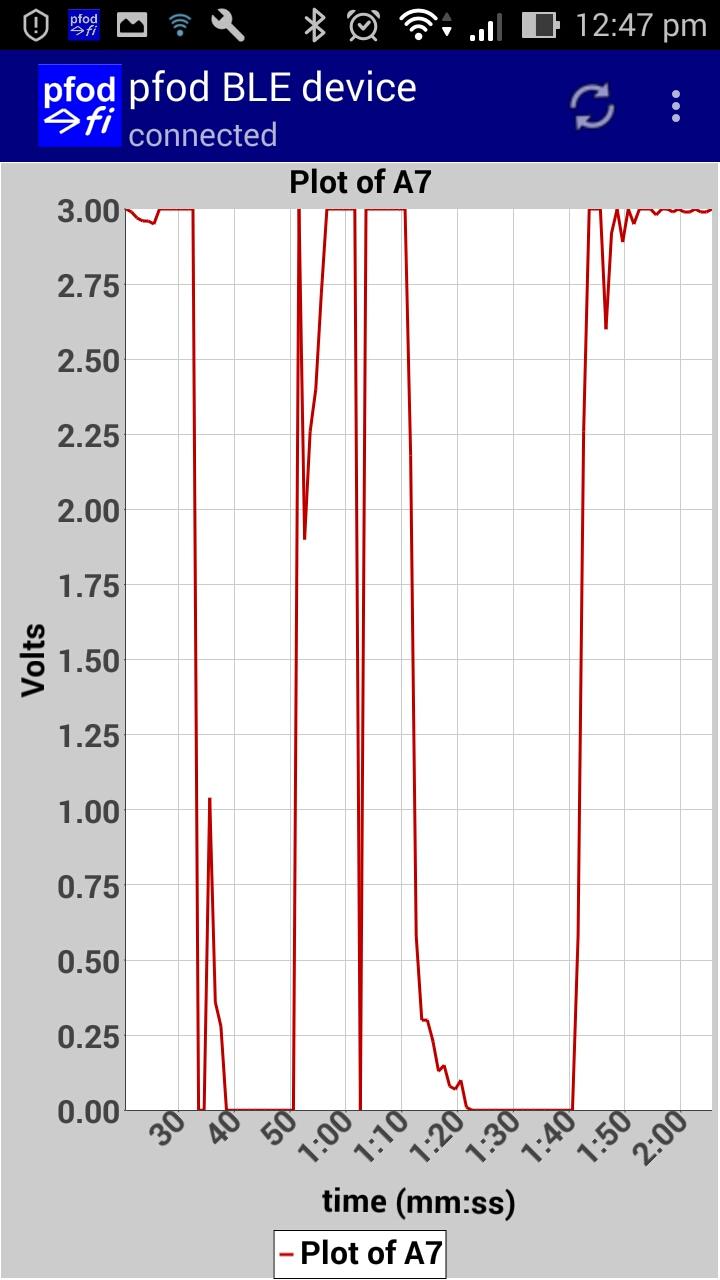

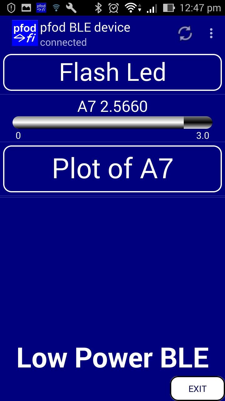

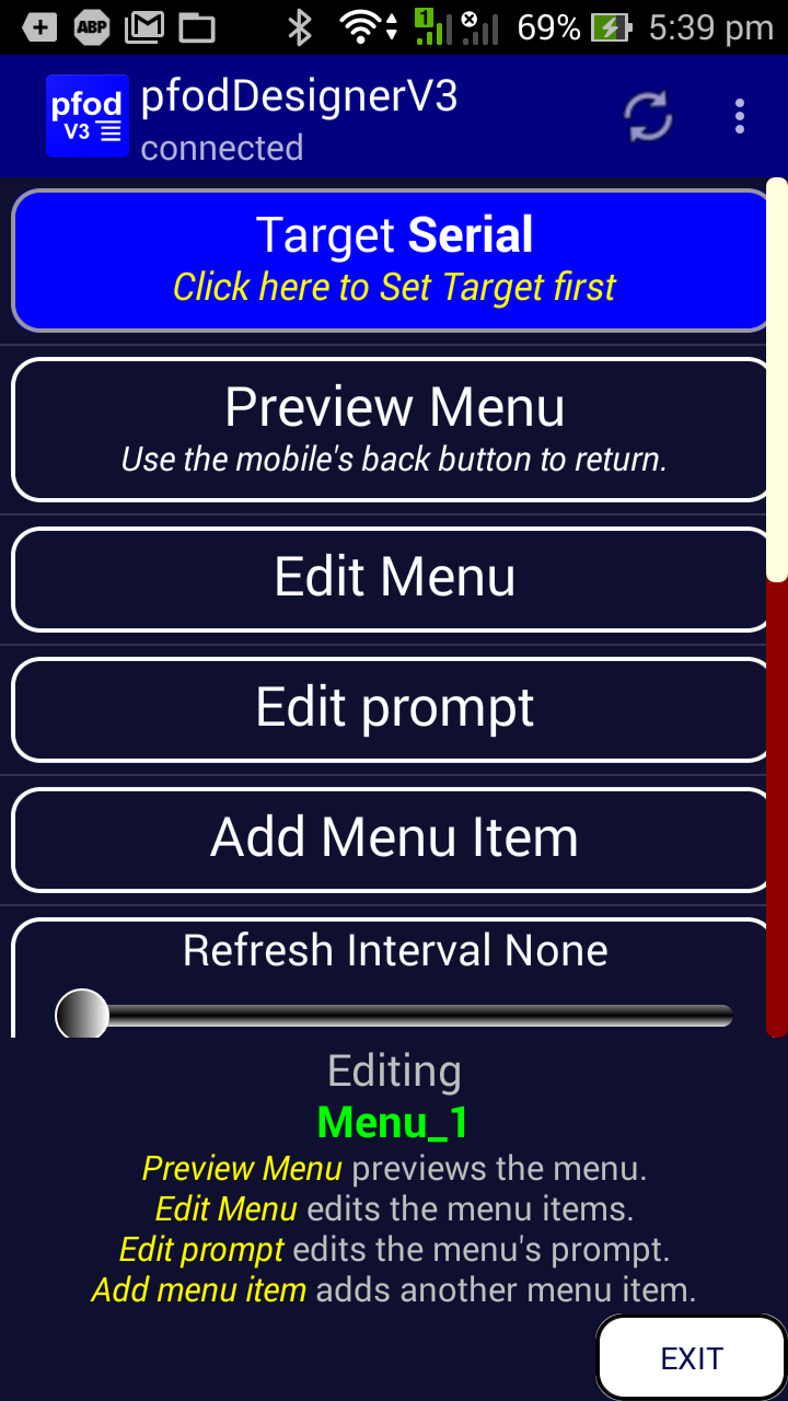

You can use the free pfodDesigner Android app to create your own custom control menus/sub-menus and log and plot data and then have pfodDesigner generate the Low Power sketch for you. You will need to use pfodApp to connected and display the menu you created, but no Android programming is required. pfodApp handles all of that for you.
There are lots of tutorials on using pfodDesigner. Here we will create a button to pulse the GT832E_01's led on for 2sec, and another menu item to display the voltage read on the A7 pin (P0.31). A third button will open a chart of the A7 voltage readings, which are also saved to a log file on your mobile.
Install pfodDesignerV3 rev 3.0.3875+ from Google Play to your Android mobile. Start a new Menu and click on the Target button and then select Bluetooth Low Energy (BLE) and then Generic nRF52832 bare modules as the target. Use your mobile's back button to get back to the Menu Edit screen.
Once the Generic nRF52832 bare modules is selected, when you go to connect an digital I/O pin to a menu item, pfodDesignerV3 displays a list of the P0... pins.
Choose a pin that is exposed by your module. Here pin P0.14 is selected to drive the external led output.
Then follow this tutorial to set PO.14 to pulse High for 2 secs.
Then add a Data Display menu item to display the value of the analogRead of A7, as described in this tutorial. Also, following that tutorial, add a Chart Button and set up a Plot to plot the A7 values. This also logs the readings to a log file on your mobile.
Note: The default ADC scale is 0 to 3.0V using the internal reference of 0.6 and a gain of 5 == 3.0V full scale and the resolution is 10 bits ie. 0 to 1024
So set Edit Display Max to 3.0 when setting up the analogRead and plot of A7
Finally, use the Generate Code button to generate the Arduino low power sketch for the nRF52832 module. Here is an example menu design, lp_BLE_GT832E_01_example.ino It displays this menu when pfodApp is used to connect. This generated sketch still uses less than 100uA, both while waiting for a connection and while connected to your mobile and updating the menu/chart and logging the data.
