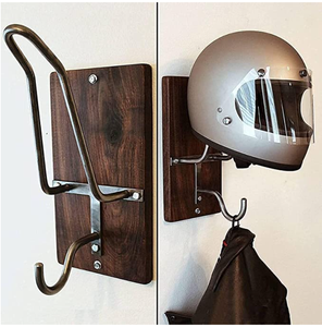

When I looked up "Motorcycle Helmet Rack" I found something like the first picture. The first one is a pretty good budget option with a little foam on the metal, but the majority you'll notice have a bare metal hanger for your helmet, using this kind of hook will damage the inner padding of the helmet over time, compressing it. Not to mention some of them are $150-$200.
I used the second 2 to base my design off of, using a similar base to the first one and using the same kind of metal pipe and fittings as the last one.

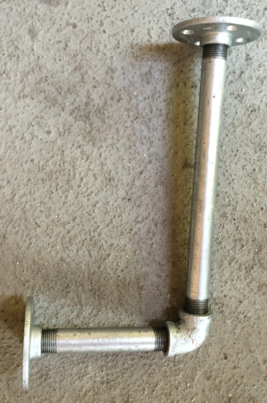

For the Flange, I just centered it at the top of the board, but you will want to check when everything is screwed in tight your "arm" for the helmet points up if it doesn't rotate the flange until it does.
Step 5: Assembling Helmet Rest and Attaching to the Board
Put your 4" piece and your 8" piece together with the 45 angled piece in the middle, with the cap at the end of the 8" piece. the cap is where you'll attach your foam/padding, I just bent the 90 degree elbow insulation around it and zip-tied it. I have a feeling I'll have to replace it after a while so if you have any ideas that might work please leave a comment!
Now screw it into your flange and make sure it points up, I left mine with no glue because I loved the idea of being able to switch it out if I came up with something better without having to take the whole thing apart or off the wall.
