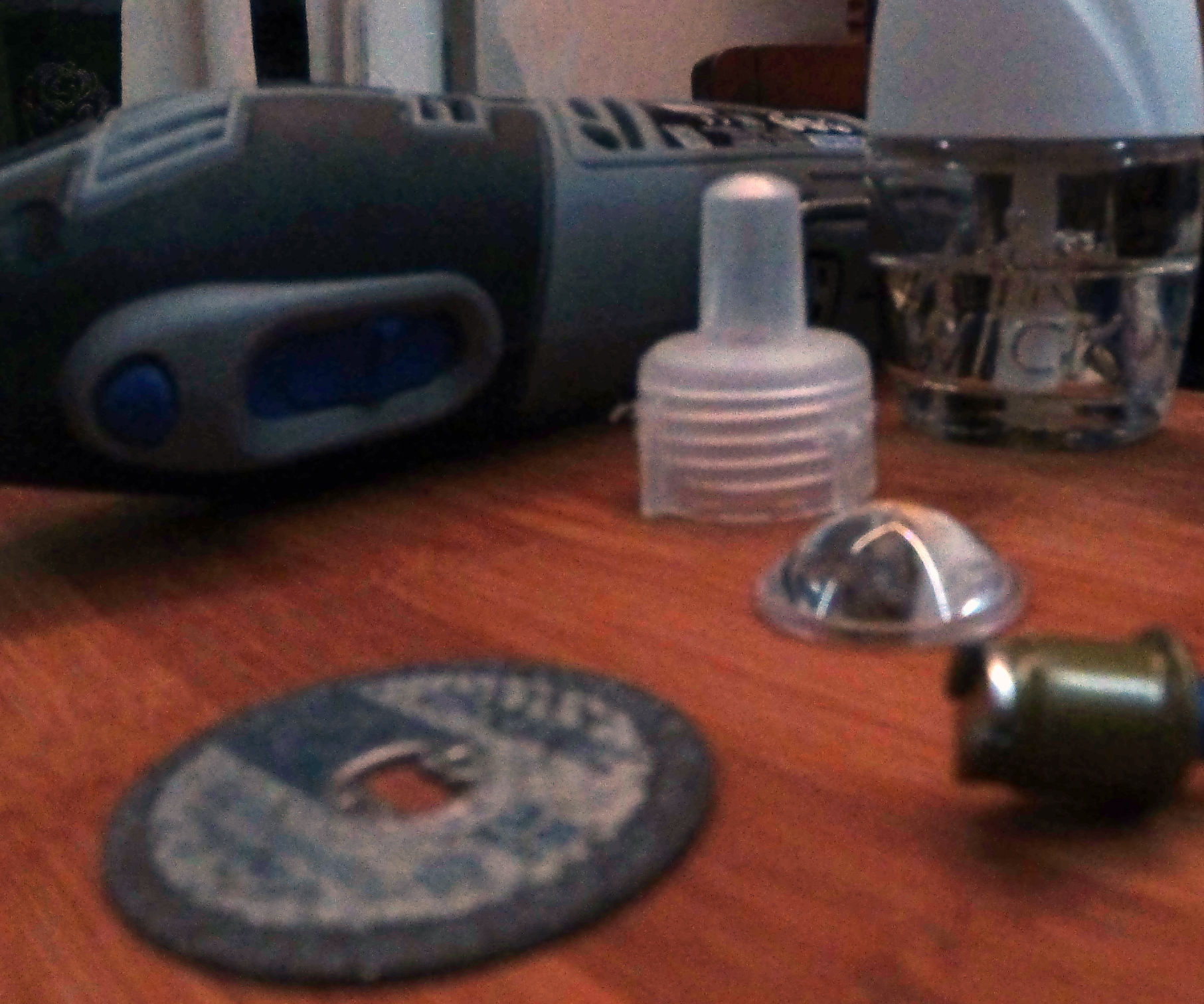

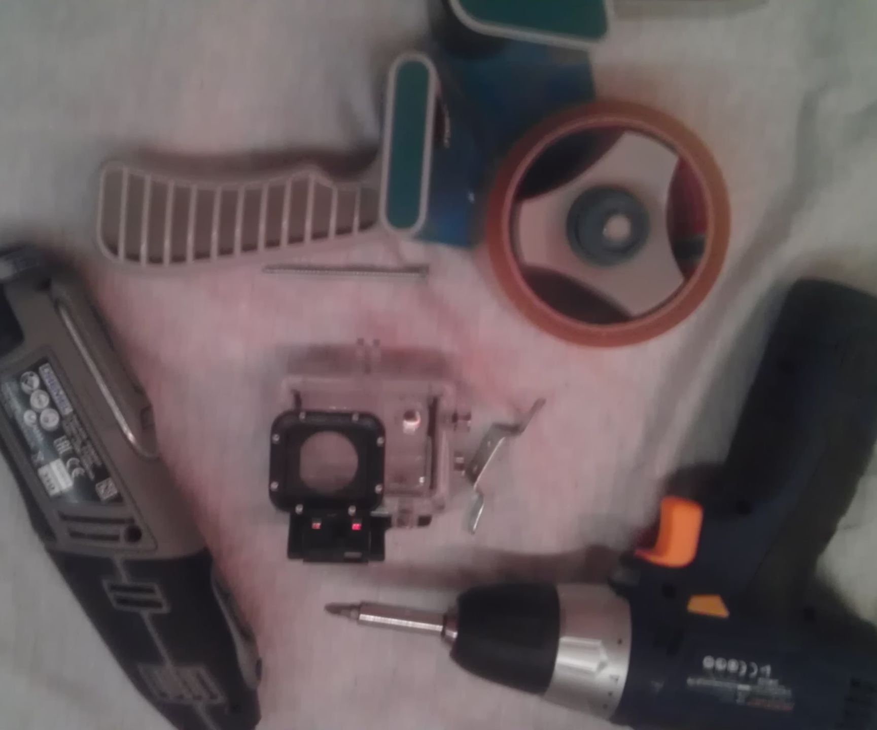

Step 2:
1. remove the bottom part of led light.
2. drill the grip from the spot shown on picture and similar angle so you don't hit ventilation hole and screw bases.
3. push the led light flex into the hole and glue it with hot glue gun. You can use other types of adhesives, I choose hot glue just incase I get a better idea later so its easier to remove.
Step 3:
You have your flex light ready, I removed diffuser plastic from mine for more equal lighting on work area.
