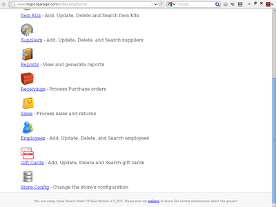

Go to your point of sale install via the browser (in our case www.myposgarage.com)
LOGIN using
username: admin
password:pointofsale
Tada! You are set up. If you are unsure where to go from here, please consult a business professional about setting up your store.
