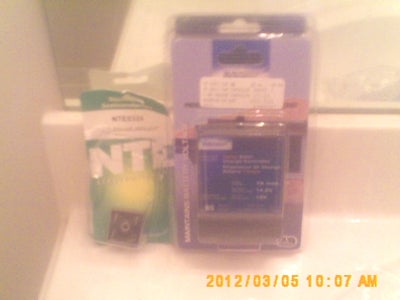

6 beefy diodes. (aka high current/high voltage.)

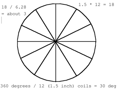

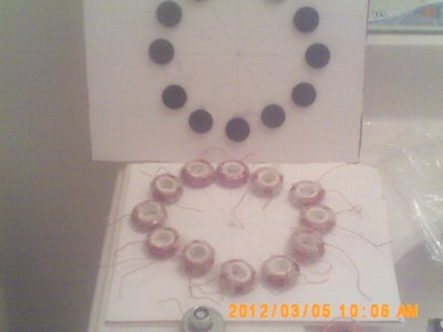

Step 4: Making the Platforms.
You can not easily draw a circle of 18 inches.
Circumference is 2 Pi r or the radius is 18 / ( 2 * 3.14) or about 3 inches.
You can draw a circle with a compass set at 3 inches.

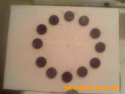

Now to place the magnets and coils we need to know where to place them.
A circle = 360 degrees. 360 degrees / 12 magnets = 30 degrees per magnet.
You will need to draw 6 diameters to get the points where to place them.
Now make a second board the same way.

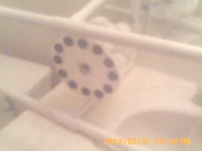

Step 5: Install the Magnets.

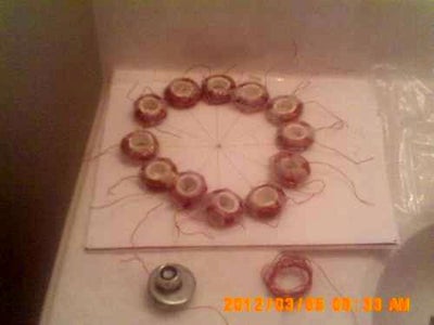

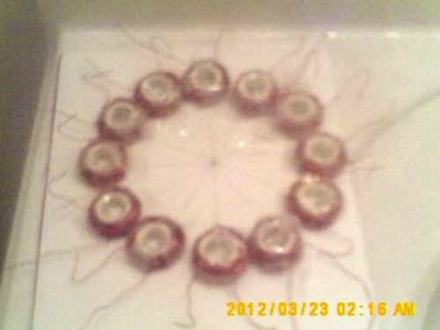

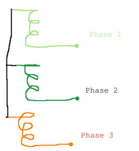

Step 6: Making the Coils.

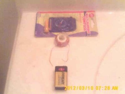

Note: you can add a battery to the coll and see how the compass reacts to the coil make sure all the coils are in the same direction. You may have to scrape off of the enameled ends to get a good contact with the battery.
Secure the coils to the base.

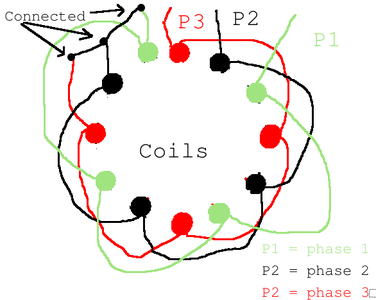

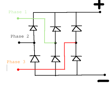

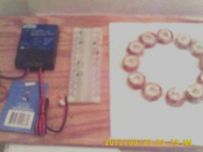

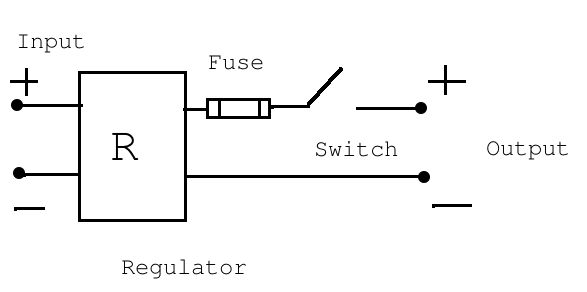

Step 7: Wiring of the Coils Together and Making the Base.
coils > diodes > voltage regulator > fuse and switch > item to be powered

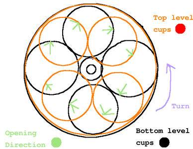

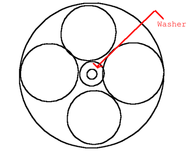

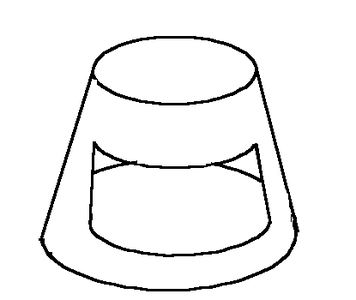

Step 8: Making the Wind Blades.
Note You could add a second level with 4 more cups at a 45 degree angle from the lower level cups.

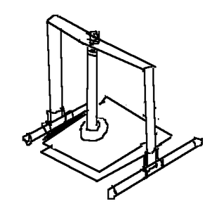

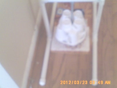

Step 9: The Frame.
Glue the two cup levels together making sure the long bolt will fit thought them easily.First level and second level should be if forty-five degree off so the wind will catch all the cups at different times. Let dry.
Put the long bolt through the unit and attach to the frame.
Step 10: Testing.
Place the frame over the base.
Once the unit is put together use varying amounts of wind say from a fan or by the turning manually of the magnet. Record the results.
