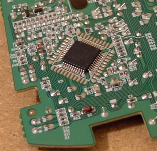

In this case, some qfp telephone chip on a pcb from a digital answering machine I still have yet to scavenge

You want to hold the magnifying glass directly over the camera lens, you want the center of both lenses over each other
Get close, watching the lcd until you get a good clear image of the item you want
Steady your hands, here I have my elbows propped up on my legs, then my hands are propped on the edge of the table.
Adjust the magnifying lens and your hands one final time, watching the lcd for the clearest image of the subject
Hold down the shutter button half way, let the camera adjust its focus, my camera flashes a green box on the screen when its got it (and a annoying chirpy noise). If all looks good on the lcd continue pushing down the shutter button to take the picture
