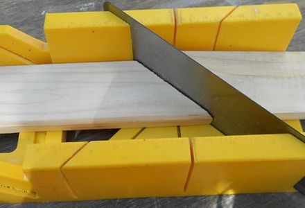

2. All four lengths need to have a mitred corner and you can easily do this with a mitre saw or mitre box and handsaw.
If you get confused when cutting the angles, cut one at a time so that you can fit the frame together as you cut each end.

You don’t need specialised tools to cut mitred edges for picture frames – a mitre box and backsaw do the job just as well.

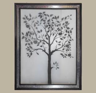

I am going to be hanging my frame outdoors and to finish off the frame I applied Gel Stain in ebony and then applied three coats of exterior sealer to ensure maximum protection.
NOTE: Don't be a dumb blonde like me. it is easier and better to apply the stain and two coats of sealer before you assemble everything and then apply the final coat of sealer once assembled.
To add a bit of detail to the frame I stuck a strip of aluminium tape around the frame, as you can see in the main pic.
