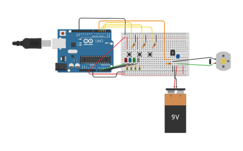

Step 1: Circuit Diagram
Materials Needed:
  1. U1 - Controller with 2 RT/RX pins (I use Arduino Nano for the interrupts)
  2. S1, S2 - Pushbuttons (2 in total)
  3. R3, R6 - 1 kΩ Resistors (2 in total)
  4. D3 - Green LED
  5. D4 - White LED
  6. M2 - DC Motor
  7. D5 - Diode
  8. T2 - NPN Transistor (BJT)
  9. R9 - 10 kΩ Resistor
  10. BAT3 - 9V Battery
  11. C2 - 100 nF Capacitor
  12. D1 - Blue LED
  13. D2 - Red LED
  14. R2, R1, R4 - 500 Ω Resistors (3 in total)
Assembly Steps:
  1. Assemble the circuit according to the circuit diagram: https://youtu.be/GmlbjBSrSPY

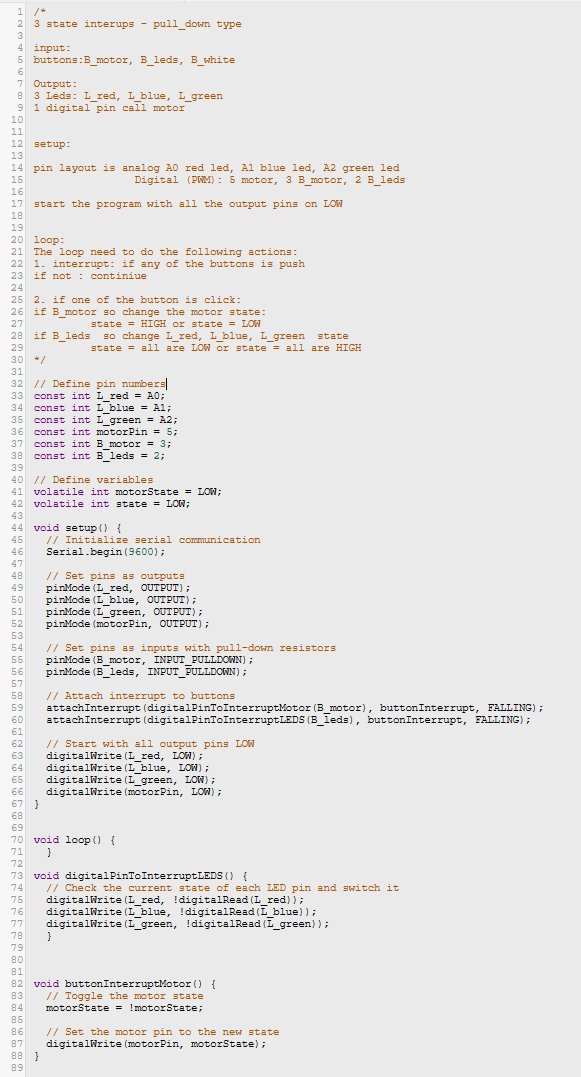

  2. Upload the code:
// Define pin numbers
const int L_red = A0;
const int L_blue = A1;
const int L_green = A2;
const int motorPin = 5;
const int B_motor = 3;
const int B_leds = 2;
// Define variables
volatile int motorState = LOW;
volatile int state = LOW;
void setup() {
 // Initialize serial communication
 Serial.begin(9600);
 // Set pins as outputs
 pinMode(L_red, OUTPUT);
 pinMode(L_blue, OUTPUT);
 pinMode(L_green, OUTPUT);
 pinMode(motorPin, OUTPUT);
 // Set pins as inputs with pull-down resistors
 pinMode(B_motor, INPUT_PULLDOWN);
 pinMode(B_leds, INPUT_PULLDOWN);
 // Attach interrupt to buttons
 attachInterrupt(digitalPinToInterruptMotor(B_motor), buttonInterrupt, FALLING);
 attachInterrupt(digitalPinToInterruptLEDS(B_leds), buttonInterrupt, FALLING);
 // Start with all output pins LOW
 digitalWrite(L_red, LOW);
 digitalWrite(L_blue, LOW);
 digitalWrite(L_green, LOW);
 digitalWrite(motorPin, LOW);
void loop() {
void digitalPinToInterruptLEDS() {
 // Check the current state of each LED pin and switch it
 digitalWrite(L_red, !digitalRead(L_red));
 digitalWrite(L_blue, !digitalRead(L_blue));
 digitalWrite(L_green, !digitalRead(L_green));
void buttonInterruptMotor() {
 // Toggle the motor state
 motorState = !motorState;
 // Set the motor pin to the new state
 digitalWrite(motorPin, motorState);
  • Note - I have decided to reconfigure the circuit to utilize two buttons. The controller now incorporates 2 RT/RX pins, as Arduino Nano manages the interrupts in this setup.

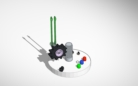

Step 2: 3D Prints
Materials Needed:
Assembly Steps:
  1. Download and 3D Print the 90 Degree Gear Box: 3D print the components using a 3D printer.
  2. Prepare the Workspace: Clear a workspace to assemble the components.
  3. Identify Components: Separate and identify each label or marking on the components.
Fish_base
Automaton_mechnics
Circuit_Base
