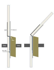

In bending, there are two big problems – holding the metal against the bending nose, and stopping the metal from sliding out of the press. Also the hinges have to be very strong.
As I haven’t any welding gear I wanted a hinge I could use with wooden boards. They are old melamine faced shelf panels. I connected them with strips of seatbelt webbing fixed with hot-melt glue. The belting is in tension when it holds the top board against the workpiece. These pictures show how it works.

To use the bender I put it in a handyman vice workbench. One board and the flat workpiece go upright in the vice. The top board will bend the workpiece and can hinge over from left to right. As shown in this picture the belts are arranged so that they are in tension when the top board is pushed to the right.
I found it was tricky to hold the board and the workpiece, and it sat too far down in the vice. So I nailed a couple of bits of thin ply to the top edge of the bottom board to stop it falling down. And I used an offcut of wood to hold it a couple of inches above the work surface.

I needed a nose to bend the plate over. I use a couple of bits of wood I had saved up. At first I could use a nose wider than the workpiece, but as soon as the sides were bent up I needed it to fit between them.
I found I needed to over-bend the aluminium by about 30 degrees since it springs back. So the nose needs to be made pointed about 30 degrees. You can why the whole thing needed to be raised up in the vice, to allow for it to bend beyond 90 degrees.

I sometimes found the nose tended to slide down. So I clamped some non-slip table mat between the workpiece and the bottom board. Here you can see one of the last bends being made. You can also see extra wood was needed to clamp the workpiece without squashing the sides I had already formed.
