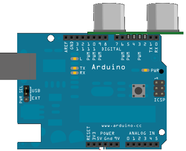

Introduction: Easy Ultrasonic 4-pin Sensor Monitoring (hc-sr04)
hello Instructables,
I have had some trouble with my cheap ultrasonic sensor (hc-sr04) and today I found a really easy solution.
It is a really simple edit of the normal 3pin code.
I added the 4 int's to the beginning of the code, so you can changes the arduino pins very easily.
The new code(4pin):
int vcc = 2; //attach pin 2 to vcc
int trig = 3; // attach pin 3 to Trig
int echo = 4; //attach pin 4 to Echo
int gnd = 5; //attach pin 5 to GND

Step 2: Trouble With the Sensor/troubleshooting
So there have been many questions about failing sensors and no output. Here are some solutions.
1) Dubble check the connection.
2) check your power source: Sometimes usb connections or 9v batteries do not deliver enough power for sensors and motors/servos. So check the output with only the sensor before you upload your final code. A bigger battery might come in handy too.
3) Use other ports: First of try using a different usb port on your computer and restart the program. Second of try using other pins to attach the sensor to the arduino

MitchellB30
MitchellB30
4 years ago
the four-pin is just plain wrong. You can't power sensors over digital I/O of arduino boards. Digital I/O pins aren't rated for enough current to power most sensors, you run the risk of damaging one or both devices. Use the 5V and GND pins, they're there for a reason.
0
MitchellB30
MitchellB30
Reply 4 years ago
After reviewing the specs for the ultrasonic sensor, the sensor only draws 15 of the 20mA max for arduino digital I/O pins. That said, its a dumb idea to power sensors off of Digital I/O and hope you down blow up your microcontroller. ploease, don't do this.
0
Giedow
Giedow
Reply 4 years ago
Thanks for the warning, but according to the arduino website the output current is only 20mA. This might be a problem for long term use, but certainly won't damage the sensor in the sort term. Furthermore, I have never had any issue with this.
Also isn't the output current equal to the current "requested" by the sensor?
