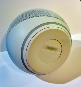

Introduction: Echo Dot 4th Generation Bolt Fixing Adapter
Having bought both an Amazon Echo 4th Gen with a screw fixing in the base and an Echo Dot 4th Gen, I was surprised that the Dot didn't use a similar screw mount fitting. I wasn't impressed with the available mounts for the Dot which either relied on gravity with the Dot usually sat in a ring or some sort of clamps which destroyed the smooth look of the Dot.
So, the solution was to add my own screw mount. The Echo uses an M6 1.5mm thread, which are almost as rare as hen's teeth. So, my first decision was what thread to use? I used an M6 1mm thread, which are common as shark's teeth (if you are a shark, that is). You can obviously choose what ever thread you want (camera mount?).

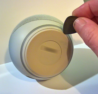

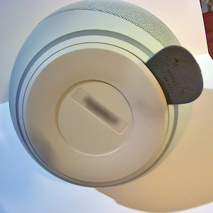

Step 1: Removing the Rubber Base Ring
In order to separate the two halves of the Dot, you must first remove the rubber antislip base ring which covers the screw holes. This is simply held on with double-sided tape. I used a guitar plectrum to lever it up without causing damage. Once it is up enough to get hold off then you can simply peel it off.
Place it aside sticky side up! You will be able to refit it at the end without needing any more tape.

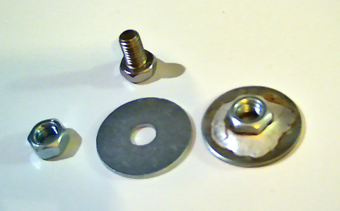

Step 3: Creating the Mount Nut Holder
Because the base is flat and I wanted the base to remain flat, I decided against using an M6 T nut as the threaded nut part would have ended up sticking out below the bottom, although I could have glued it upside down. I also didn't have an M6 Tee nut. The solution was to take a nut and a washer and solder the nut to the washer.
To do this I simply bolted the nut temporarily to the washer . I then used a blowtorch to heat up the washer and nut and then applied solder all around the nut. If you don't want to solder you could of course use a suitable Epoxy glue.
This join doesn't need to be hyper strong. Its use is simply to stop the nut spinning when fitting the bolt to fit the Dot, whilst the washer helps to spread the load. The nut to washer joint itself isn't carrying any of the load of the mounted Dot.
