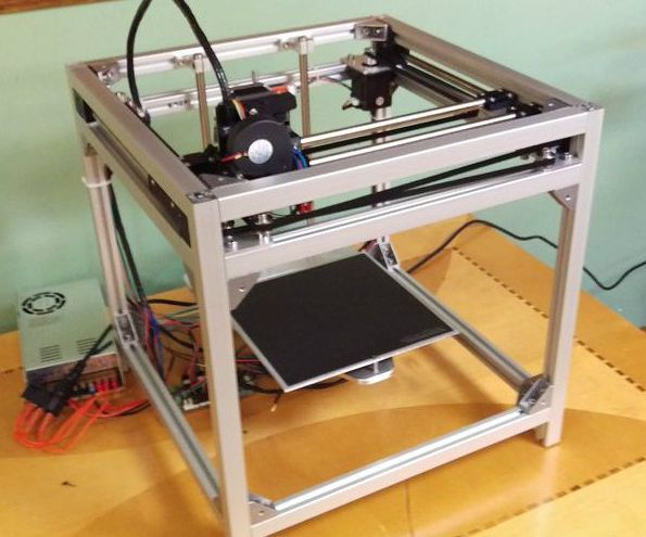

Yes yes it is finally that time. Perhaps the most exciting time of the entire 3D printer build. And also the most stressful if something goes wrong. So, before you continue make sure you followed all the previous steps word for word. If you have, you shouldn't have any problems. If not, I sure hope you know what you're doing!
Lets make it move! Make sure your PSU is plugged into the wall and the sd card is in your Azteeg. Flip the power switch to power up the board, make sure all 4 lights come on. Now plug the board into your computer. Go into Repetier host and hit "connect" in the upper left corner. The button should turn green and now say "disconnect." If it did, you're good. If not, double check your printer settings in Repetier. Now lets make it move....
On the right hand side, click on the "Manual Control" tab. Now make sure your printhead and print bed are near the middle of their travel, you don't want them to accidentally hit the ends! Hold your breath and press the right arrow for the x axis to move the printhead 10mm. You should see the printhead move very slightly to the right then stop. At this point you may hear some faint whining noises, that is normal when the stepper motors are powered up.
Test out the y and z axis, making sure the printer moves in the positive and negative directions for all 3. Then, press the button below the control panel which de-powers the steppers (see picture). As long as your printer successfully moved in all 3 directions you are good to go. If the axes were wrong or something doesn't work, don't worry as this will be fixed next!

Step 8: Breaking in the Eclips3D
Well sort of, this will break in the mechanics side, not the hot end side. Don't worry, it's super easy! Simply grab the files below. Then in repetier go to the preview tab. Then click the icon that says load. Load up the first script you just downloaded. You should see a G28 command then followed by a bunch of G1 commands. Now grab a beer and hit run, but stay with the printer as it completes these! Your printer will automatically do a bunch of moves to test and break in the axes. The first file only does the x and y axis.
If at any time you hear the printer skipping steps (it sounds exactly as you would expect it to), immediately stop the program. Try to move the parts by hand and if you just noticed it was a rough spot you can try running the program again. If it happens repeatedly, stop and determine if the problem before proceeding. Common causes are too much pre-load tension on the x axis or misalignment.
After the program finishes, repeat the same process with the second file you downloaded. This one is only for the z axis. Before running the program, manually move the z axis to its home position. The reason for this is because by default in the Eclips3D firmware, the z axis homes at a relatively fast speed. Before it is broken in, this may be too fast for it! If the Z axis skips steps during the last motion, this is ok as it is an extreme test and likely will never be moving this fast!
After successfully running both programs, you can home all the axes and you're good to go!
