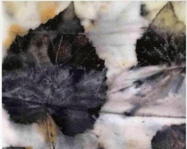

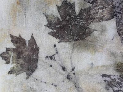

The way I understand it, Eco Printing is a form of natural dyeing where the colors from plant material are transferred to paper or fabric via steaming or boiling.

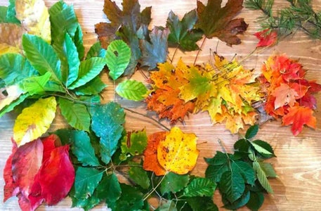

3 Pick the right Leaves
- Some leaves and trees that contain tannin: Black Walnut, Oak, Maple, Eucalyptus, Birch, Willow, Sumac, Laurel and Grape.

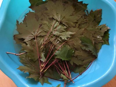

4 Prepare the Leaves
- Soak the leaves (fresh or dried) in warm water for an hour or more.

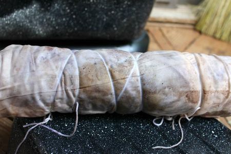

8 Roll or Bundle Tightly
- A tight roll ensures good contact between the cloth and the plant material resulting in clearer prints.

- Place the Leaves and Flowers the fabric and fold it over or cover with a second piece of fabric
- Tightly roll the folded fabric onto a PVC pipe or heavy stick
- Steam or simmer the bundle
