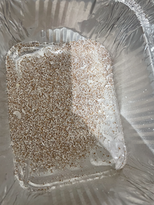

Mix the ingredients in a glass container over a flame to thicken Leave to act for 6-7 minutes, carefully add teaspoons of chopped egg shells,finally adding a pinch of thermoactive powder.Place a drop of sunflower oil in the molds. Once you have reached a homogeneous and fairly dense consistency, pour into silicone molds and leave to cool.
Step 2:
Take the egg skins and clean them with soap and water. Then boil them in a saucepan. Then, dry them in an oven for 30 minutes and, finally, blend them until they become a powder.
Step 3:
Afterwards, take water, add gelatin and glycerin, and mix the mixture. Then put it in a saucepan and add a little thermoactive powder.
Step 4:
Take some silicone moulds, add a drop of sunflower oil and spread it well so as not to let the mixture stick to the base. Then add the eggshell powder.
Step 5:
Make an initial casting, then apply a light fabric such as tulle. Make a second pour, then add the eggshell powder on top. Finally, wait for it to dry.

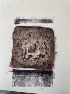

When the material is ready, it can be used for decoration and intaglio printing.
