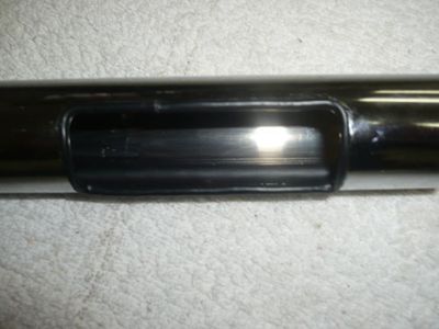

Step 5:
With this seal must cover the whole edge of the quarry, fixing it with drops of cyano acrylic. Do not overdo the glue, I suggest you dip a toothpick and smudge the edge of the tube as you go to insert the gasket. This work will protect your phone scraping effect of the tube.

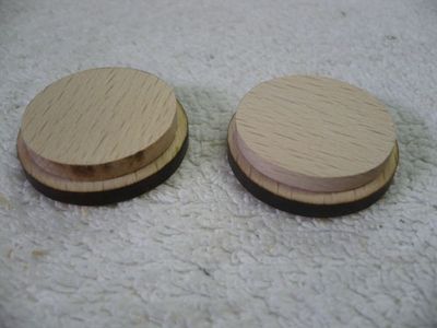

Step 11:
Cut now two discs of wood with a diameter slightly smaller than the tube and also cut two discs with a diameter of 4 mm larger than the tube. With a pyrography I darkened the thickness of large disks, it's just a matter of aesthetics.
Step 12:
Glued with vinyl disks on those small ones. When the glue is dry you can secure the plugs in the heads of the pipe using hot glue.
