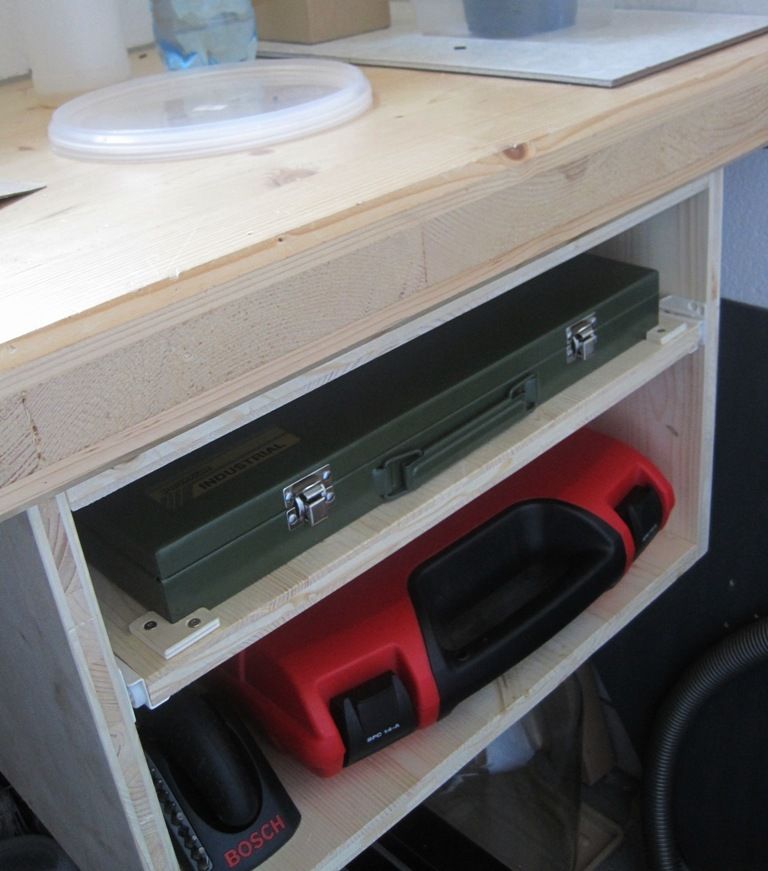

A very neat but simple thing I came across making was a desk for my home. There were some problems with off-the-shelf desks. I had some wishes, and so, I decided to make it CNC milled, here is why:
· I needed a generally higher desk (about 75 cm or 29 ½ inch) since I am a tall person
· A nice, sturdy desk which is able to be taken apart is awesome in case the desk has to be moved.
· Low part count
· Easy and quick feasibility on the CNC mill
· Only one board of material
The last three reasons are because of the cost of this desk. Long-winded assignments for the carpenter’s CNC mill are very costly, since the operating hours are more expensive than the material itself. If you have more than one board of wood, the cost will explode (student speaking) since they have to take the time to put another board on the mill for your job. It’s only a desk after all.
So, out of what did you make it exactly?
My design is milled on one 17 mm “multiplex” board which is 2,5 m by 1,25 m
It is designed to be put together without (almost any) tools and then, if needed, to be taken apart with completely no tools at all.

1. At first, look if there is a part missing. If not, sand down all of the edges a little bit.
2. Connect each table leg with another one. Use a rubber mallet. With four screws on each leg, mount the pieces (as shown on the picture). Make sure the screws won’t penetrate the other side!
3. Plug the six bars into the just assembled table sides. Lock the two lower ones with the locking connectors.
4. Now, place the tabletop on the structure. With the four small wooden rectangles fixed to the tabletop, it won’t be able to move anymore and contribute to the stiffening of the table. Done!
When disassembling the table, you don’t need to undo the screws! Just take it apart in the opposite order. You will have: A Tabletop, six bars, two desk sides and four locking connectors ready to be stored away.
Please note: The desk on the photos doesn't have the pieces on the legs yet. In my case, they haven't been milled at this moment.
