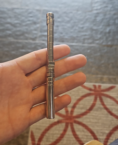

  12. Cilindrical magnets (we used small neodymium disc magnets and mixed and matched them up for our required damping. We used around 18cm total length of magnets - so 9cm length per cilinder - with 1cm diameter)

Step 3: Adding the Magnets
Then, we drilled holes into the wood so we could attach screws. We did this because the magnets can attach to the screw and we can easily pull them off. We also added a bit of hot glue to the screws and the bolts on the wood so it would not get loose.
This has to be levelled with the holes in the aluminium. so the magnets can perfectly go through without friction.
Disclaimer: If you want it permanent you can simply just hot glue the magnets to the box.
