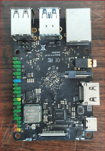

Brainy Pi
ethernet / wifi

Step 2: Setting Up Bluetooth
To switch on the Bluetooth use the command
sudo hciconfig hci0 up
1. Once the Brainy Pi’s Bluetooth is powered on we need to go ahead and switch on the Low Energy Advertising mode and set it to the Non connectable undirected advertising mode.
sudo hciconfig hci0 leadv 3
2. Now that we have put our Brainy Pi into the right mode, we need to advertise some data with it.
This time we will be utilizing the hcitool, this tool will allow us to send a command to our Bluetooth device to broadcast a specified URL.
sudo hcitool -i hci0 cmd 0x08 0x0008 19 02 01 06 03 03 aa fe 11 16 aa fe 10 00 03 70 69 6d 79 6c 69 66 65 75 70 07 00 00 00 00 00 00
