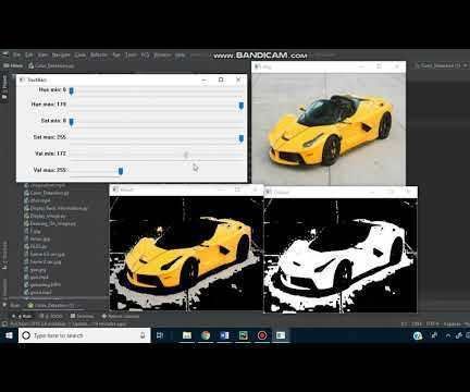

- cv2.namedWindow("canny") --> This line of code is used to create a new output window and name of the window is given as canny(You can give any name you want)
- After that I am making a variable switch and inside that '0 : OFF \n1 : ON' this means if my trackbar will be on 1 then only I can adjust the values.
Now we will be creating 2 TrackBars, one for lower value and one for upper value. We will be using createTrackbar function of openCV. First we will see the syntax of this function.
cv2.createTrackbar('WINDOWNAME','MAINWINDOWNAME','RANGE'). This might be confusing but don't worry we will go through each and every step.Creating TrackBar for lower value:
cv2.createTrackbar('lower','canny',0,255,nothing). In this lower is the trackbar name, canny is the main window, 0 is the position on which our slider will be and 255 is the range means the silder will move from 0-255In similar way you can create other two trackbars
Step 4: Getting Trackbar Position
Ok so now we are going to read trackbar bar values so we can apply it to our image. We will get the values using cv2.getTrackbarPos() function.
lower = cv2.getTrackbarPos('lower', 'canny')
In the above statement I am creating a variable name lower in which I will store the value of lower value. So inside cv2.getTrackbarPos 1st argument would be "lower" because I want lower values (The spelling must be exactly same as it is createTrackbar function) and 2nd argument would be the name of the trackbar window to which it belongs.
Repeat the same process for rest of the functions as shown in the above image
