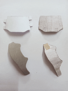

Step 2: Making Prototype 1
Prototyping is key to turning an idea into a real product—it helps you figure out what works and what doesn’t before committing to the final design.
For my first prototype, I focused on getting the dimensions of my finger. I used masking tape for this: I wrapped the tape around my finger with the adhesive side facing outward so it wouldn’t stick to my skin. Once my finger was fully covered, I carefully removed the tape to get a mold of my finger. I then split the mold into two sections and taped a 9 mm blade piece to the tip.
This prototype gave me a general shape to work with and served as a template for the next stages of development.
Step 3: Making Prototype 2
With the second prototype, I focused more on the shape and structure of the finger cap and blade holder.
To start, I carefully cut open the first prototype, laid it lat on a piece of paper, and traced its outline. This gave me a basic template for the cutting tool. I then cut out the pieces from a 300 gsm sheet of paper and built the blade holder using masking tape and additional paper.
By the end of this stage, I had a somewhat working prototype and could start focusing more on refining the design.

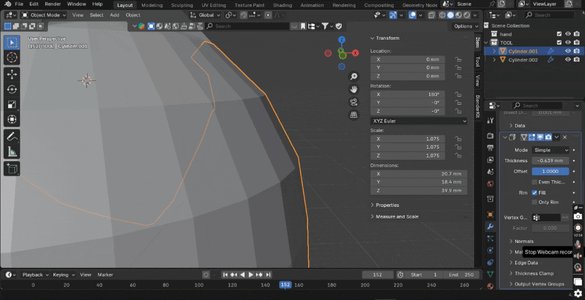

Step 7: Making the 3D Model (Setup)

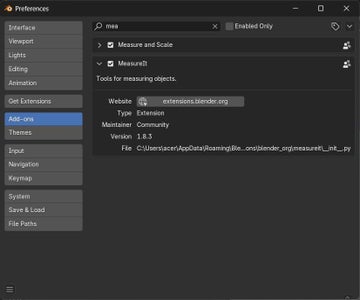

To create the 3D model of the exoskeleton, I used Blender. While Blender isn’t particularly known for precision modeling, I improved its accuracy by enabling the MeasureIt add-on and setting the unit scale to millimeters.
The MeasureIt add-on allows you to take precise measurements of your parts, which was critical for designing my model accurately.

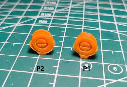

My design includes two movable positions with joints. To ensure that the joints could be printed as a single piece while still maintaining movement, I conducted several test prints.
I first printed the model, inspected it for errors, and then adjusted the dimensions where needed. After three iterations, I was able to achieve a fully functional joint.

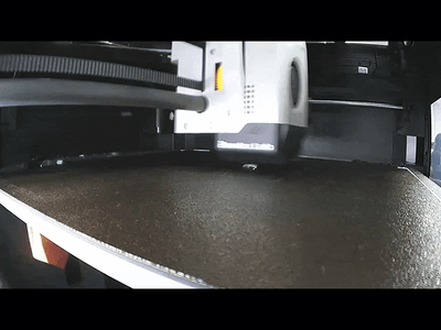

Step 10: Modeling the Final Design
I began by modeling the blade holder, reinforcing it with additional supports and incorporating the design details from my sketches. Next, I created the joint that connects the front section to the midsection of the exoskeleton.
The joint that connects the midsection to the knuckle was slightly different, since I decided to print the knuckle section separately for better accuracy. Once all components were completed, I exported the models.
Finally, I arranged all the parts on the build plate and started the final print.
