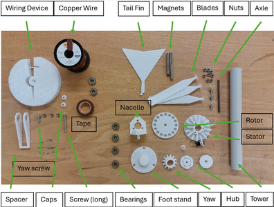

Step 1: Overview Parts
  1. 1 Axle
  2. 1 Tape
  3. 1 Stator
  4. 1 Rotor
  5. 11 Hex nuts
  6. 6 Ball bearings
  7. 1 Pipe (Tower)
  8. 1 Foot stand
  9. 32 Magnets 3x10mm or 16 Magnets 6x10mm
  10. 3 Blades
  11. 2 Hub (Front and back part)
  12. 1 Nacelle
  13. 1 Yaw
  14. 1 Copper Wire
  15. 1 Wiring Device
  16. 2 Small caps
  17. 1 Big cap
  18. 3 Screws (M6 x 10)
  19. 1 Screw (yaw fixation) - (M6 x 5)
  20. 1 Screw (long - M6 x 20)
  21. 2 Banana plug sockets 12 mm outer diameter
