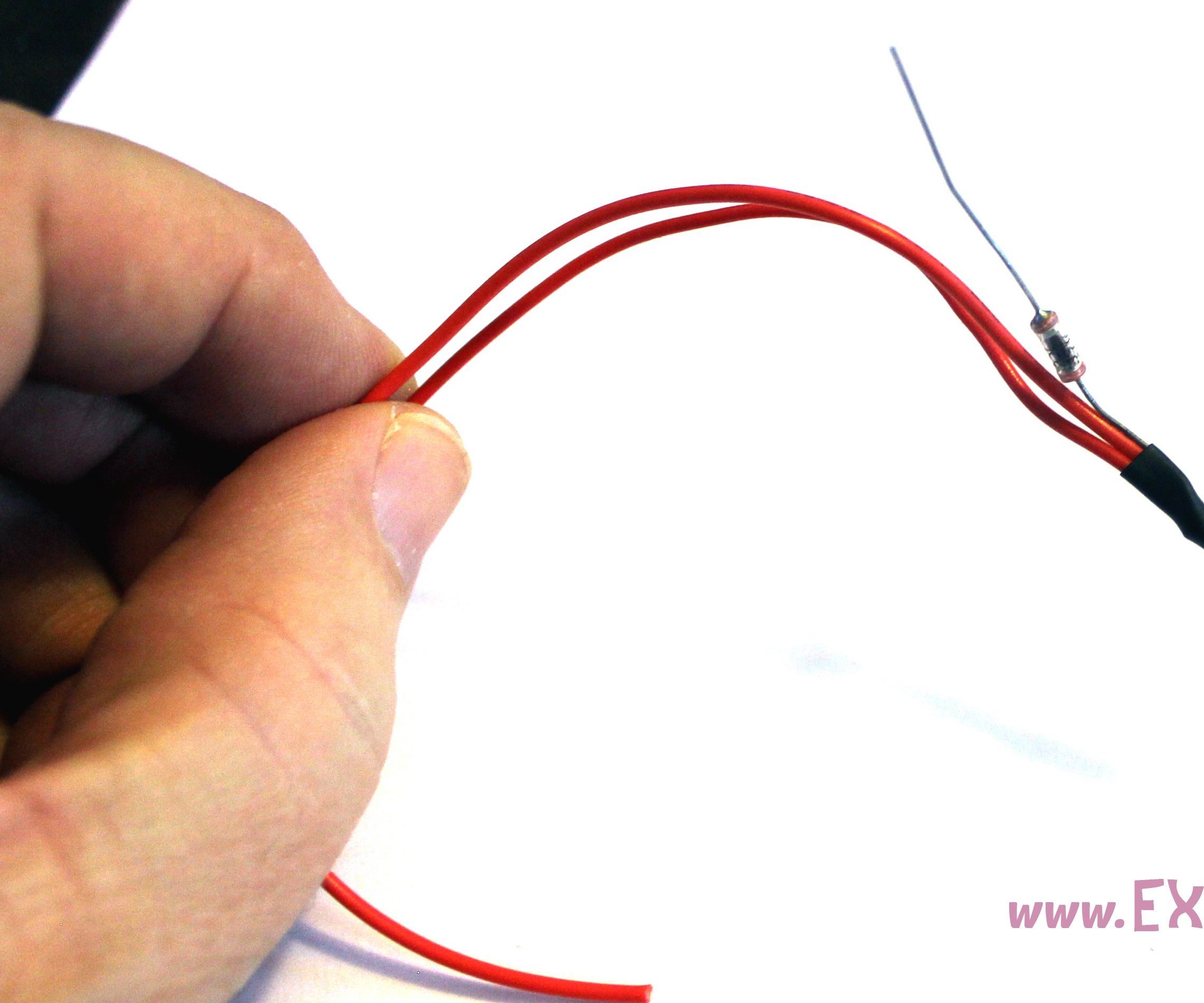

9. Test the strip by connecting an ohmmeter to the two connecting wires. My strip measures around 2K ohms when straight, and goes well under 500 ohms when bent. I took the photo before I attached wires.

Step 7: Coming Soon: Applications
Applications are for an upcoming Instructable. For now, this is how you can interface the sensor to an Arduino or Raspberry Pi through an analog input port. Experiment with resistor values to give a good voltage swing. It depends on the resistance range of your own sensor. For example, a sensor range of ~2K to ~250 ohms with a 470 ohm resistor will produce a voltage swing of approximately 2.5 volts to approximately 4.8 volts.
