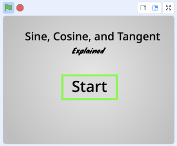

Once you have a topic, the first part of the program is the title screen. To make one, first create a new backdrop and call it "start screen." I recommend labeling everything in the program (sprites, backdrops, broadcasts, and costumes if there are multiple) with a descriptive name to keep the program organized. Then, use the text option to write the name of the topic you are explaining. Once you do this, you can decorate the backdrop however you want in the costume editor, such as adding a background color or image.
I set up my project by making each backdrop like a different slide and the user can navigate through them by pressing the right arrow. For this, on the code section of the backdrop, add the code in the images above, to make the backdrop change when the user presses the right arrow key. This is not the only way to set up the project, as you could have a home menu with different buttons to press, but I find this way the easiest to create.
The last thing on the title screen is a start button. Create a new sprite called start button, and draw a shape that says Start on it. Add the code in the image above which makes the button only appear on the title screen and no other backdrop. Then, add the code which switches to the next backdrop when the button is clicked. After this is done, the program is set up and the title screen is complete. Let's move on to the information in the program.

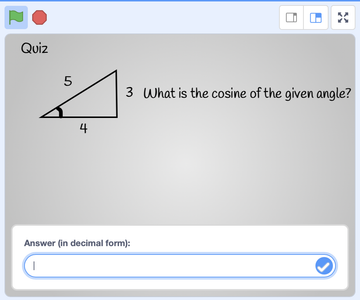

A great feature of using scratch is asking interactive questions where the user has to type the answer, and you can let them know if their answer was correct or incorrect. The question appears as a pop-up, and the user has to enter an answer to continue. This helps the user learn by testing their knowledge. You can have a large quiz at the end, or have practice questions throughout the slide.

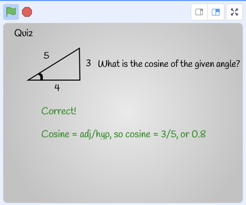

To add a practice question, first create a new backdrop called "quiz." In the backdrop editor, type the question you want to ask the user at the top, and include a diagram if needed. Then, on the code section of the backdrop, follow the code shown above. When the backdrop switches to this slide, you ask the user for the answer and wait until they respond. When they do respond, if the answer is the right answer (you type the correct answer in the empty space in the code; for me, it's 0.8), then a correct answer message is broadcasted, and if the answer is anything else, then a wrong answer message is broadcasted.
After this, create two new sprites: one for the correct answer message, and one for the incorrect answer message. For the correct answer, create a new sprite called right answer and type a message in the editor for the user letting them know they are correct. It is also helpful to add the reasoning behind the question or an explanation. For the wrong answer, do the same thing, but call the sprite wrong answer and type a message telling the user they were incorrect, as well as an explanation. On the code section of these sprites, use the code above, that makes the message hide whenever the backdrop is not on the quiz slide, and appear whenever it is called for by the broadcast.
