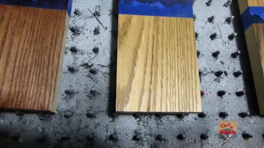

Step 1: Plain
The first block, I left it plain, bare wood.

Step 3: Natural Stain
This is what it looks like after drying a couple of days, with Minwax Natural Stain.
