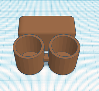

Step 1: Creating the Plant Pots and Attaching Them Together
Ok, so first start a CAD Tinkercad project, and have the workspace blank. Now follow the instructions I am going to tell you below, they are also in the pictures above for image reference.

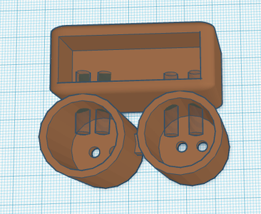

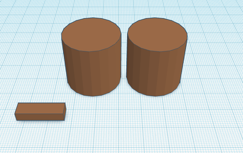

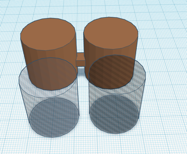

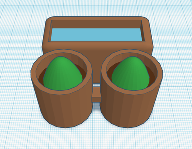

• First, drag and drop 2 cylinders from the basic shapes category and color them brown. ( Picture 1 )

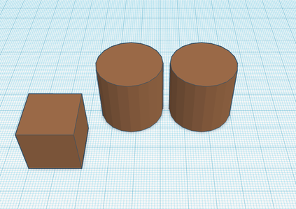

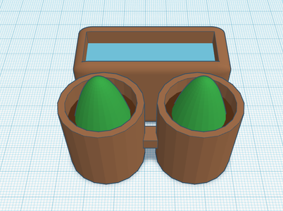

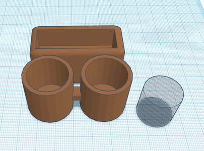

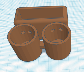

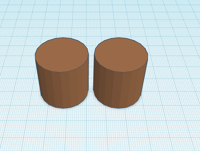

• Next, scale the cylinders to a 26 length and 26 width millimeter measurement. ( Picture 2 )
• Then, put them to a height of 26 millimeters. ( Picture 2 )

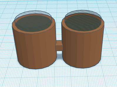

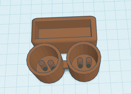

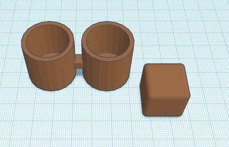

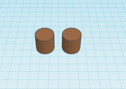

• Now, drag and drop a box from the basic shapes category and color it brown. ( Picture 3 )

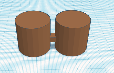

Levitate the box to 4 millimeters, the width of the box to 6 millimeters, and the length of the box to 20 millimeters, and position the rectangle between the 2 cylinders.
• Next, drag the rectangle up 7 millimeters and group everything together.

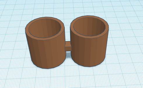

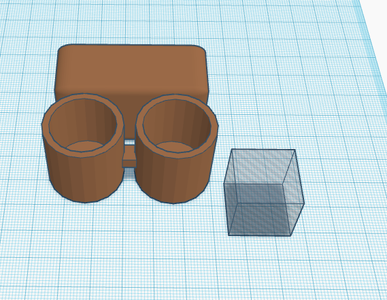

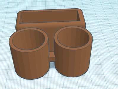

• Now, create 2 cylinder holes that have a diameter of 22 millimeters and a height of 26 millimeters.
• Position the holed cylinders inside the cylinders that you have already created and levitate the holes up 3 millimeters. Then, group all of the shapes together.

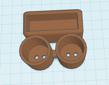

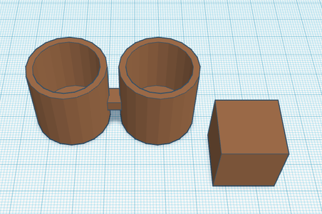

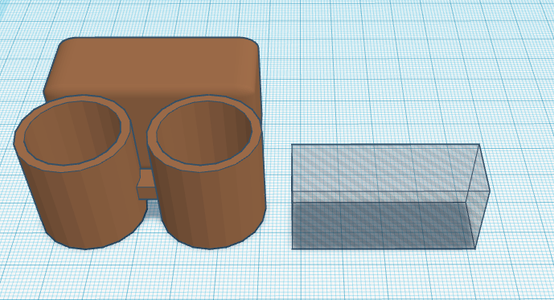

• Finally, you want to create a default box and color it brown.
• Then you give the box a radius of 2. Finally, resize the dimensions to 22 millimeters width, 51 millimeters length, and 28 millimeters height, push the box behind the cylinders, and group them together.

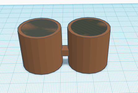

• First, drag and drop a cubic hole from the basic shapes compartment on to the workspace.
• Resize it to 44 millimeters length, 15 millimeters width, and 20 millimeters height and position the hole in the middle of the box and levitate the hole up 15 millimeters.

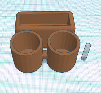

• Next, group all of the shapes together to form the hole inside the box. This is where the water for your plants will be stored. Also, drag and drop a hole cylinder from the basic shapes category.

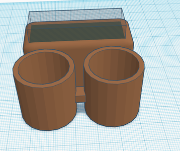

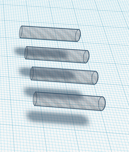

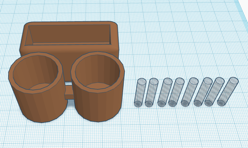

• Now, make the length and the width 4 millimeters, and make the height 20 millimeters. Go ahead and duplicate it so that there are 8 of the same cylinders.
• Next, position 2 holed cylinders on the right planting pot around the center (reference image). Then, 2 on the left pot around the center.
• Next, group it. These holes will serve as a drain to prevent your plants from getting overwatered.
• Now, rotate the remaining cylinders 90 degrees and rotate the remaining cylinders 90 degrees again (reference Image).
• Go and use 2 holed cylinders to connect the box to the right pot 17 millimeters off the ground. Do the same for the left (Reference image). Finally, group them. You are all done now!
