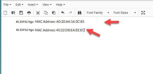

Step 2: Getting the MAC Address
Repeat this step for both TTGO ESP boards:
  • Start Visuino as shown in the first picture Click on the "Tools" button on the Arduino component (Picture 1) in Visuino When the dialog appears, select "TTGO T-Display ESP32" as shown on Picture 2
  • Connect pin MAC Address to Serial Pin [0] as on (Picture 2)
  • In Visuino, at the bottom click on the "Build" Tab, make sure the correct port is selected, then click on the "Compile/Build and Upload" button.
  • Then click on the "Serial" Tab and click on the button "Connect"
  • You should see the MAC Address as on (Picture 3), In case you do not see it, click the "Reset" button on the ESP Board
  • Copy the MAC Address to your Notepad as on (Picture 4)

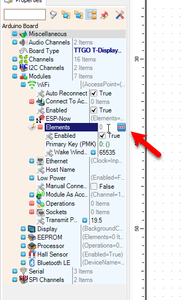

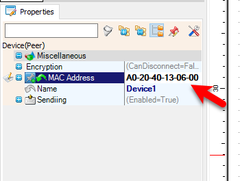

  • Select the "TTGO T-Display ESP32" board and in the Properties window extend Modules>WiFi>ESP-NOW>Elements and click on the 3 dots Button
  • In the Elements window Drag "Device(Peer)" to the Left side and in the Properties window paste the MAC Address of the other Board TTGO T-Display ESP32

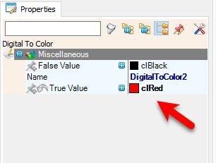

  • Select "DigitalToColor1" and in the properties window set "True Value" to clGreen
  • Select "DigitalToColor2" and in the properties window set "True Value" to clRed

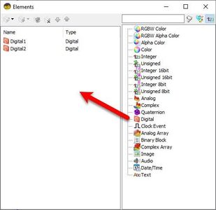

  • Double click on the "MakeStructure1" and in the Elements window Drag 2X "Digital" to the Left side
  • Close the Elements Window
  • Double click on the "SplitStructure1" and in the Elements window Drag 2X "Digital" to the Left side

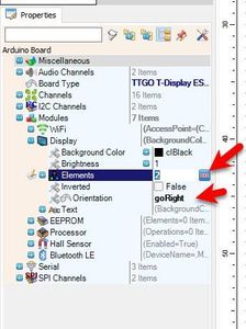

  • Select "TTGO T-Display ESP32" board and in the properties window expand "Modules>Display>Orientation
  • Set Orientation to:goRight

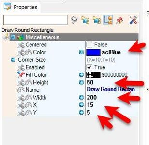

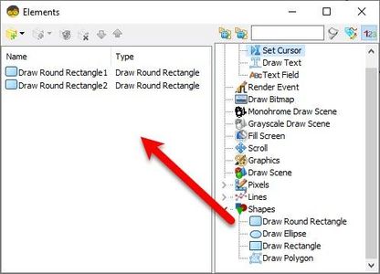

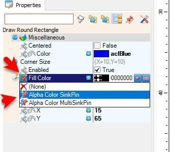

  • In the "Elements" window drag "Draw Round Rectangle" to the left side and in the properties window set "Color" to aclBlue, "Height" to 50, "Width" to 200, "X" to 15, "Y" to 5

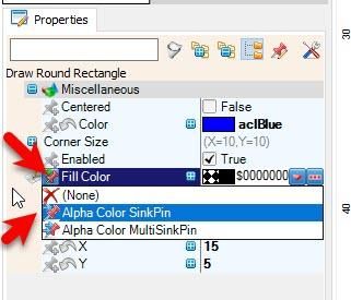

  • Select "Fill Color" and click on the Pin icon and select "Alpha Color SinkPin"

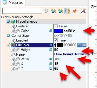

  • In the "Elements" window drag "Draw Round Rectangle" to the left side and in the properties window set "Color" to aclBlue, "Height" to 50, "Width" to 200, "X" to 15, "Y" to 65

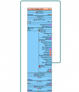

Step 6: In Visuino Connect Components
  • Connect TTGO T-Display ESP32 Button [Right] to "MakeStructure1" > "Digital1" pin [In]
  • Connect TTGO T-Display ESP32 Button [Left] to "MakeStructure1" > "Digital2" pin [In]
  • Connect "MakeStructure1" pin [Out] to TTGO T-Display ESP32 ESP NOW Sending Pin[In]
  • Connect TTGO T-Display ESP32 ESP NOW Sending Pin[Out] to "SplitStructure1" pin [In]
  • Connect "SplitStructure1" > "Digital1" pin [Out] to "Button1" pin [In]
  • Connect "SplitStructure1" > "Digital2" pin [Out] to "Button2" pin [In]
  • Connect "Button1" pin [Out] to "TFlipFlop1" pin [Clock]
  • Connect "Button2" pin [Out] to "TFlipFlop2" pin [Clock]
  • Connect "TFlipFlop1" pin [Out] to "DigitalToColor1" pin [In]
  • Connect "TFlipFlop2" pin [Out] to "DigitalToColor2" pin [In]
  • Connect "DigitalToColor1" pin [Out] to "ColorMultiSource1" pin [In]
  • Connect "DigitalToColor2" pin [Out] to "ColorMultiSource2" pin [In]
  • Connect "DigitalToColor1" pin [0] to TTGO T-Display ESP32 > Display > "Draw Round Rectangle1" pin [Fill Color]
  • Connect "DigitalToColor1" pin [1] to TTGO T-Display ESP32 > Display > "Draw Round Rectangle1" pin [Clock]
  • Connect "DigitalToColor2" pin [0] to TTGO T-Display ESP32 > Display > "Draw Round Rectangle2" pin [Fill Color]
  • Connect "DigitalToColor2" pin [1] to TTGO T-Display ESP32 > Display > "Draw Round Rectangle2" pin [Clock]
