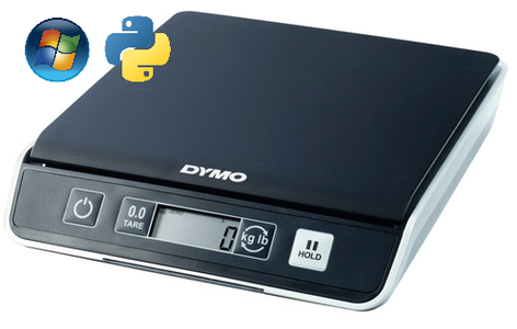

Welcome to this instructable on reading scale values from Dymo M5 and M10 scales using Python!
The Dymo M5 and M10 scales are reliable devices used in various applications. With the power of Python, you can tap into these scales and retrieve weight readings programmatically.
In this tutorial, I'll walk you through the process of connecting your Dymo scale to Python and extracting weight measurements effortlessly. We'll cover hardware and software requirements, provide step-by-step instructions, and share code snippets to read scale values like a pro.
By the end of this instructable, you'll have the knowledge to leverage Python and your Dymo scale, making weight measurements a breeze. So let's dive in and discover the magic of reading scale values with Python!

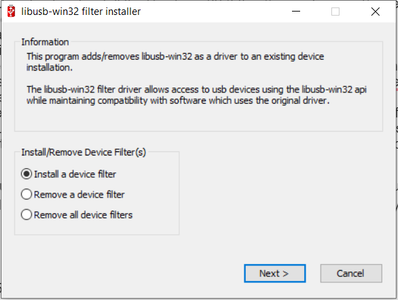

  1. Install libusb-win32: Download and install the libusb-win32 (https://sourceforge.net/projects/libusb-win32/) backend on your Windows computer.
  2. Connect the USB scale: Plug in your USB scale to your computer using the USB cable. Make sure the scale is powered on by pressing the power button.
  3. Windows device detection: Windows should automatically detect the scale and install the necessary device driver. (You should see a popup that says something like "Dymo M5 device drive installing")

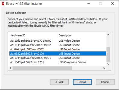

  4. Filter installation: Use the libusb-win32 Filter Wizard to install a device filter specifically for this scale. The Filter wizard should start automatically but if it doesn't you can search for Filter Wizard in the search bar (See image). In the wizard, you'll see an entry in the list that looks like "vid:0922 pid:8003 rev:0100 USB Input Device" - select it and proceed with the installation. (See Image)
By following these steps, you'll have libusb-win32 installed, the scale connected to your computer, and the appropriate device filter in place.
