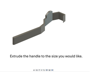

I seldom use pencil sketches, a lot of this is trial and error so with the egg in the design we can make our sketch and extrude to a depth we are comfortable with.

The next task is to add the mounts firstly for the center piece, this is the component where the plunger will slide up and down, this is sketched from the top of the handle, the sketch is then extruded the full depth of the handle, then we stop sketch and use the end of the newly extruded part, to sketch a rectangle or square to this to create a cut out in which the center component will fit.
