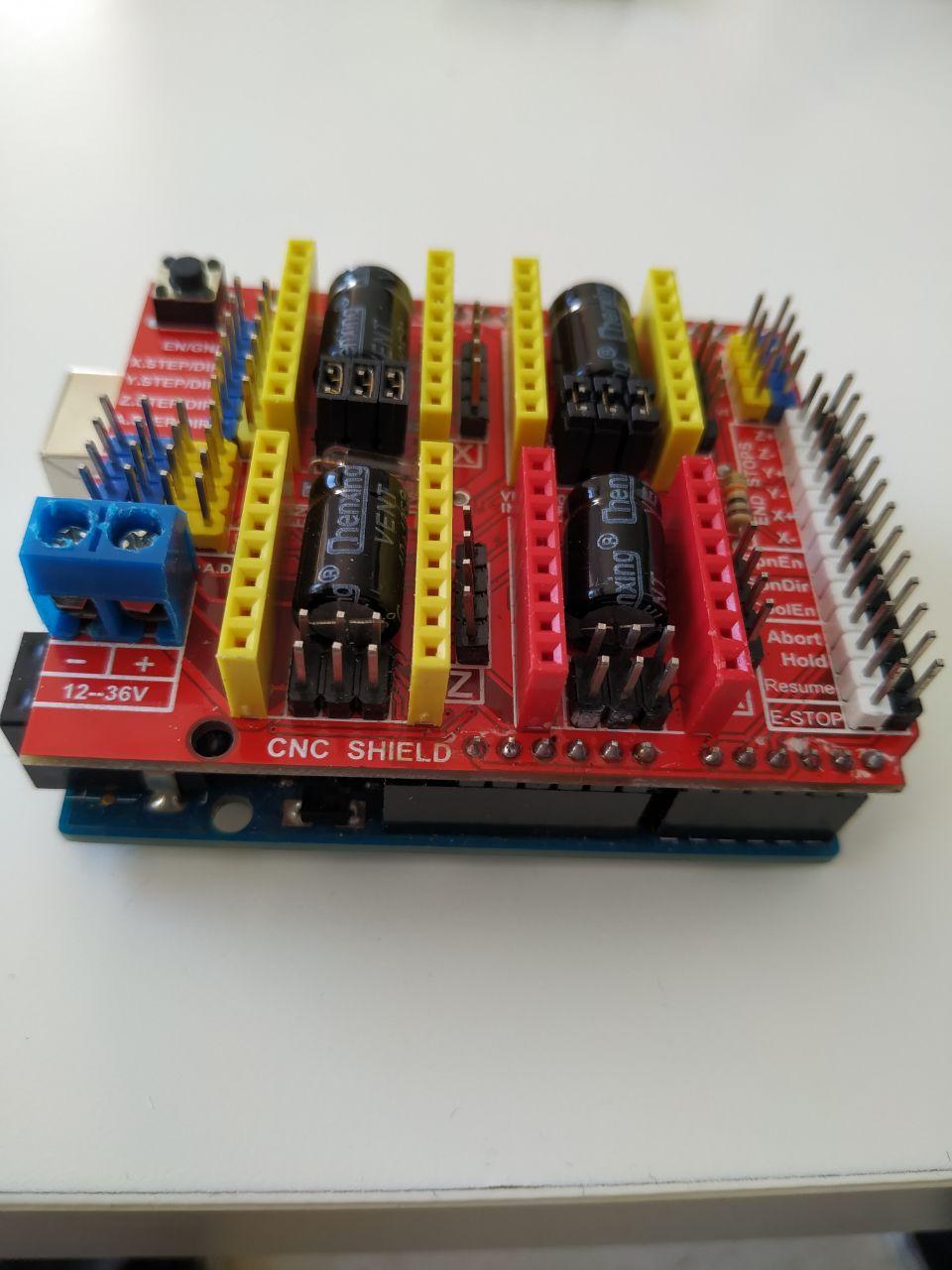

Step 5: Electronics

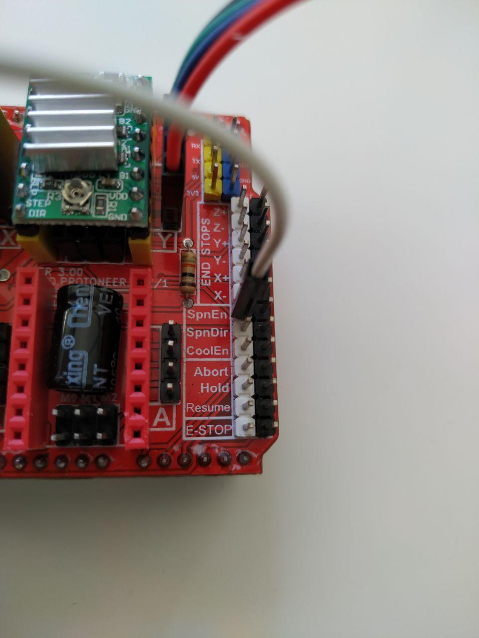

First you have to attach the CNC shield to the Arduino UNO. Just make sure align the pins correctly and put some pressure to secure it. After that you will have to put the (6x) jumpers on the X and Y spots on the CNC shield as shown in the picture. These jumpers allow us to control the steps of the motors.
Then you have to connect the (2x) A4988 drivers on the X and Y spots for them in the right orientation as shown in the second picture, you can now insert the wires from the stepper motors.
Now it is the time for the servo connections. First you have to somehow separate the wires that usually comes together. In this case we separated them using (3x) male to female jumper wires, and we attached them using tape. After that you have to identify the data wire (it is usually yellow coloured) and you have to connect it to the white SpnEn pin on the CNC shield. Finally, you connect the red pin to 5v5 and the brown or black to GND.

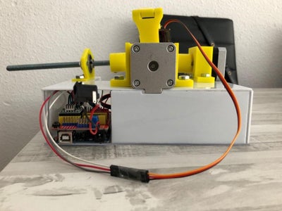

Step 6: Creating the Frame
As we said, we built the main frame entirely of acrylic. First we cut the parts as shown in the picture, and we glued them together to form a nice little box. Later we attached all the components to the acrylic frame. We left an empty space opened to have access to all the connections of the electronic components. It is very important to make sure that everything is well aligned, or the egg will not rotate as it should and the pen has to be just in the middle of the egg holders in order to let the marker draw well.
