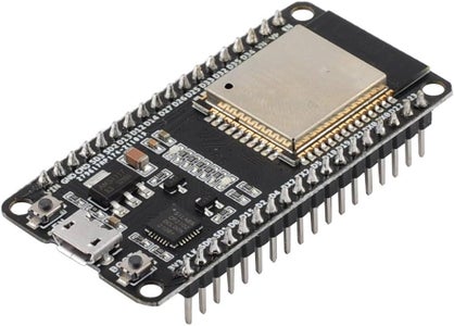

For this instructable you will need:
  • Arduino IDE
  • ESP32 Microcontroller
  • ESP32 Sensor Shield
  • Sensor Extension Wires
  • 10mm Blue LED
  • Speaker
  • PS/2 Joystick Module
  • Blynk console user
