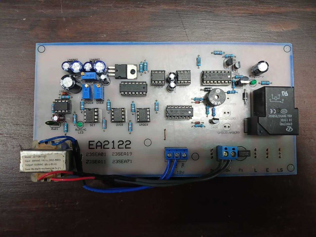

Step 4: PCB Designing and Printing
Designing and printing the Printed Circuit Board (PCB) came next after the schematic diagram was complete.
ExpressPCB was used to design the PCB. To guarantee correct alignment and spacing, the parts from the schematic layout were carefully positioned and routed on the board. Built-in design rule checks (DRC) were used to verify that the layout complied with the necessary mechanical and electrical requirements. The Gerber files were created and ready for production once the design was complete.
The PCB was manufactured utilising the toner transfer method, which involved using a laser printer to print the PCB design onto glossy paper while maintaining correct alignment for the transfer procedure. Afterward, a copper-clad PCB was ironed with the printed design. A protective layer was formed on the copper by the toner being transmitted by the iron's heat. The surplus copper was finally removed from the PCB by etching it in a ferric chloride solution, leaving only the traces that the toner had covered.
Step 5: Component Soldering and Finalizing PCB
Soldering the parts and completing the board for use in the ElectraGuard came next once the PCB had been manufactured and etched.
To avoid any residues, oils, or dust that can interfere with the soldering process, the PCB was cleaned. To guarantee a clean surface, alcohol or a fine abrasive pad were utilised. Then, in accordance with the design, every component including resistors, capacitors, ICs, LEDs, and the relay—was meticulously positioned in its proper location on the PCB before being soldered to it. Careful soldering was used to prevent solder bridges between neighbouring pins and guarantee solid, clean connections. For accuracy, a soldering iron and fine solder were utilised.
After every component was soldered, the connections were examined visually to make sure there were no bad connections or short circuits and that every part was firmly fastened. To check for continuity and make sure there were no shorts and all the wires were connected correctly, a multimeter was utilised.
Following soldering, isopropyl alcohol or a specialist PCB cleaning solution was used to clean the PCB once more to get rid of any flux residues.

Step 8: Final Outcome
The ElectraGuard was successfully completed and fully operational, offering a reliable solution for protecting electrical equipment from damaging voltage fluctuations.
