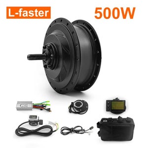

Step 2: Buying a Kit

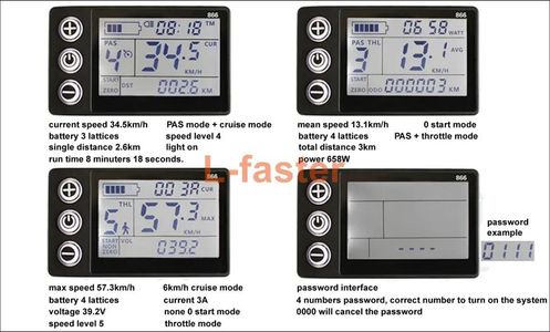

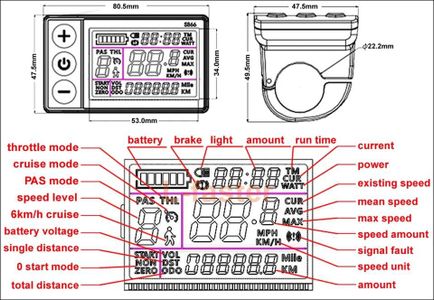

This 36v kit was sourced from LFaster Store on Aliexpress. It contains a 500w Brainpower controller, S866 LCD screen, twist grip throttle, brake levers, peddle-assist sensor, and front hub motor (for 100mm+ forks).

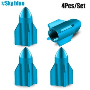

Spokes and the rim are not included with the e-bike kit. I had to buy them separately and chose 10 gauge (3.2mm) stainless steel spokes. The hub motor was not designed for such thick spokes so the holes were drilled a bit larger so the spokes would fit. Spoke length was calculated from https://ebikes.ca/tools/spoke-calc.html and was found to be 177mm. It could have been about +5mm longer without an issue. The wheel was trued and balanced at a local bike shop. The tires it has are 2.5" Maxxis Hookworm and take a "fat tire tube 2.5 to 3 inch" sold on Amazon. Tire caps are aluminum and rocket shaped.

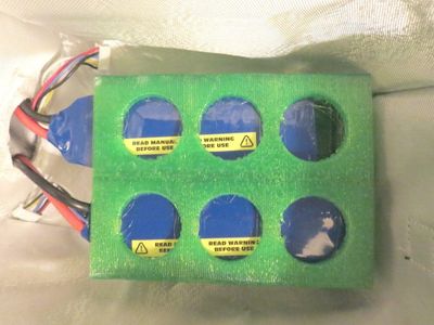

Step 7: Building a Battery Pack
The battery is made from four 18v 5amp-hour Lithium Polymer quad-copter batteries. They are lighter and provide more powerful than 18650 packs. Two 18v batteries are joined in series to make 36v. Then two 36v packs are joined in parallel. The batteries are encased inside a 3d printed rubbery material. The pack stays inside a fire-resistant bag all the time. I bring the pack inside to charge and leave the bike outside. You could put two 4-battery packs in parallel for double the capacity. The connectors will likely spark when the battery is connected to the controller. You can prevent wearing out your terminals by using a heavy duty, high current switch; or by limiting current (amps) temporarily using a resistor in parallel with a power switch.
Rubbery battery pack enclosure: https://www.thingiverse.com/thing:5511860
Batteries used: https://hobbyking.com/en_us/turnigy-5000mah-5s-30c-lipo-pack-xt-90.html
Packs joined with XT90 "serial" and "parallel" cables, and terminated with female Dean's T adapter connector.

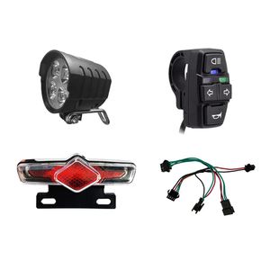

Step 10: Lights and Reflectors
I added a headlight / taillight kit that hooks into the e-bike controller and runs on 36v to 60v. Found on aliexpress. Also has turn signals and a loud horn. I also have a simple bell that makes a standard ring-ring noise. A quiet, standard bell is less scary to pedestrians.

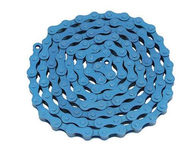

Step 14: Chain Replacement
Chain was replaced with a blue painted version. It was cut to size and installed using a chain breaker tool. Rear axle chain tensioners were installed to keep the chain from moving and getting loose.

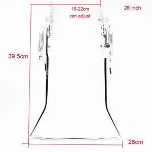

Step 16: Kickstand
The SE So Cal Flyer bike doesn't come with a kickstand. I added a cheap frame kickstand but it broke after only a couple weeks. Will be trying U-shaped double kickstand mounted to front wheel.

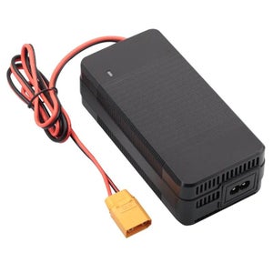

Step 17: Charging
The charger has been adjusted using the potentiometer (screw knob) inside the case to be 41.1v maximum voltage instead of 42v. The batteries will puff up and get really hot if you go above 42v (4.2v per cell). So it's safer to charge to a max of 41v. They charge at 5 amp without a BMS and it takes about 3 hours to charge. Connector is a Deans / T type. A BMS might allow the battery to have more charge/discharge cycles.
Stay in the same room when charging your battery, or charge it outside away from anything else using an extension cord. If there's battery smoke, unplug it and put it outside ASAP.
