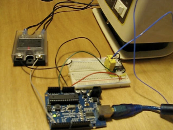

Step 3: Electronics
Here is the arduino code I used:
WiiChuck.h and ServoTimer1.h are both available on-line. Drop a message if you want them and cant find them.

Step 4: WiiChuck Steering
The Demo step shows what's connected with what. The Electronics step has the Arduino code that does it.
