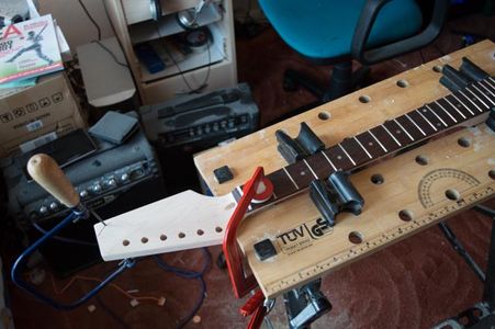

- Guitar neck - I used an unfinished strat neck with an unfinished headstock, as you can see above (the headstock hasn't been cut out yet. Make sure that it has a truss rod, which can be used to adjust the angle of the neck.

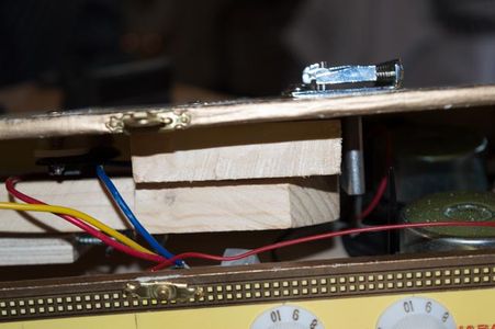

My design, pictured above, focuses on keeping the string tension away from the cigar box, which would definitely not be able to withstand the tension. It also uses a pre-made guitar neck off Ebay. Basically, the neck bolts onto a piece of wood that runs through the box where it is connected to the bridge through the box lid. As shown above, an extra piece of wood with a hole for the bridge pickup is bolted onto the length of wood to give the height required to meet the lid of the box. For the tremolo system to work, a channel has to be dremelled out of the main length of wood to fit the springs.
This structure is able to withstand the string and spring tension fine, and the box doesn't take any of it.
Study the images above, measure out your box and design something similar.

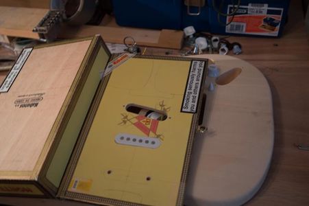

Step 3: Making Holes in the Cigar Box
You now need to make holes for the pickups, potentiometers, strap nuts, bridge, neck, output jack and sound holes.
I did the pickup holes first. Since I bought a pre-wired pickguard I could lay the pickguard over the cigar box and trace out the positions of the pickups. If you don't have a pickguard you can easily find templates online. Be careful when making the holes, you don't want to make a wrong move and put a hole in the box where there shouldn't be one. To make the pickup holes, I drilled a hole big enough for the coping saw to get in through, inserted the coping saw by taking the blade off then re-attaching the blade through the box, sawing out the hole then filing/sanding the hole down. Drill two holes either side for the pickup screws.
The holes for the pots could just be drilled. Remember to drill small holes for the little extrusion on the pot to fit into. I had to widen the top of the pot holes so that the hex nut would actually fit onto the pot to secure it in place. Drill holes for the switches, the output jack and the strap nuts in the same way. There should be one strap nut on the bottom of the box and one on the left of the top surface where the neck goes in.
I made the channel for the pickup selector by drilling a series of small holes and filing them into a single channel.
The hole for the bridge must be smaller that the bridge itself. For a tremolo bridge, it only needs to be big enough so that the part that extends downwards from the bridge can rock back and forth freely.
Don't worry about the neck hole being perfect, there needs to be a little room so that the lid can be opened and closed once the neck has been attached. It should be slightly less deep than the depth of the wood plus the depth of the neck.

Step 4: Cutting the Headstock
Fairly simple. Print off a template of your choosing and cut around it.
When attaching the machine heads, make sure that you don't tighten the screw too tightly as the head can snap off.

If it all works go ahead and attach everything to the inside of the box. I made sure that I used more wire than needed so that the wooden assembly could easily be fitted in.
When attaching the pickups, technically there should be springs in between the box lid and the pickups, however, I needed to raise the pickups more to be closer to the strings so I left them out. You'll have to experiment.
