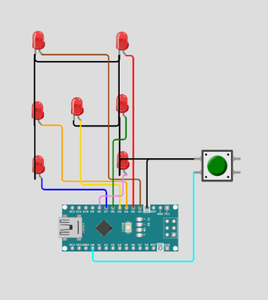

Step 1: Wiring
  1. Connect the positive (anode) leg of each LED to a separate digital pin(from D2 to D8) on the Arduino through its corresponding 220-ohm resistor.
  2. Connect the middle led to 5, top left led to 2, top right led to 3, middle left led to 4, middle right led to 6, bottom left led to 7 and bottom right led to 8.
  3. Connect the negative (cathode) leg of all LEDs to the common ground (GND) on the breadboard.
  4. Connect one terminal of the push-button switch to A0 pin on the Arduino, and the other terminal to the common ground (GND).
