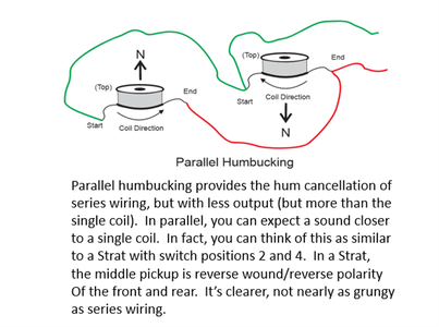

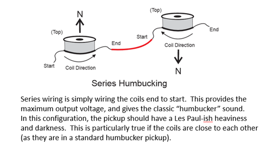

Pickups come in 2 basic varieties. One are single coils. A guitar such as a Stratocaster uses this type. The pickups is a magnetic field and a single coil of wire. They have a nice, clear, bright sound. I prefer the darker, heavier sound of a "humbucker" pickup--think Gibson Les Paul. The choice is yours. I've included write up of humbucker construction. If you prefer, just wind one coil and run it straight, as in the document, you can wire single coils either in series or parallel. Note in single coils, the magnetic fields and coil directions are the same. These are not hum cancelling, but do have a characteristic sound. Series wiring will always produce more output than parallel.
In the hum cancelling, or hum bucking configurations, the coil direction and the magnetic field directions are opposite of each other. "humbucking" generally refers to these coils being right next to each other, where as "hum cancelling" places the coils further apart. The middle pickup on a Stratocaster is reverse polarity/reverse wound from the other 2. In the diagrams, I have arbitrarily assigned "north" and "south" on these. The absolute direction does not matter--what matters if if they are in the same or opposite directions. Some folks test by using a magnetic compass. I just test to see if the poles attract or repel. If you wire up your instrument and it sounds very quiet, check the magnet directions, and if that checks out, make sure the coils are wired oppositely. (this is an issue with "phase". Sometimes, pickups are intentionally wired out of phase. It produces a weird gong like effect. See Peter Green's excellent "Green Manalishi", or Brian May's guitar lead on "We are the Champions")

Notice from the pickup winder, I have used 8000 turns of wire on 1 coil, and 6000 on the other. It is important to mark the start and finish ends of the coil, and also note which direction they are wound. In mine, I wound one with the top facing the pickup winder, and the other with the bottom facing the pickup winder. Alternatively, you can wind them the same way, and just wire one of them backwards.
Read the documents for details--in humbuckers, the magnetic field direction and the coil direction are opposite of each other. Before gluing or wiring anything, double check and make sure of the magnet direction. I test this by making sure if you put the two tops of the pickups together, the magnetic fields attract. This indicates one is north and one is south. The absolute direction doesn't matter--what matters is that they are opposite of each other.

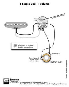

A 250k potentiometer seems to work great as a volume control. See the image (taken from the excellent Seymore Duncan website). It shows all the relevant wiring--the pickups to the volume control, out through the jack. It also shows that the string should be grounded. The diagram shows the wiring for a single pickup--it works just as well with 2 singles or a humbucker.
