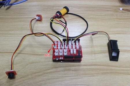

Step 5: Crowtail Adjustable Infrared Sensor
But there has a problem need to be solved, how could we determine the chance to record fingerprint? We pick up a Crowtail adjustable infrared sensor to help us, when our finger cover the glow in infrared by the infrared sensor, it will trigger the fingerprint sensor to read the fingerprint. Look at the picture, just connect it to D9 with its special Crowtail interface.
Step 6: Button and Buzzer
So if we want to make others obtain the “key permit”, we need to set a button for reread. Now when we press the button, it could record fingerprint, (note: record fingerprint should be divide into two steps: record and confirm, so you need to press your finger on sensor twice). A 3 PIN Crowtail cable and a Crowtail button will do this job well when you connect it to D10.
Then how about add a buzzer to remind us when someone put the wrong fingerprint on the sensor? I think it will make our Fingerprint lock become more “smarter” and we just add a step for connecting the Crowtail buzzer to D12 as pictures show.

6 Discussions
4 years ago
can you provide the schematic diagram of this project?
4 years ago
This is a nice project I just noticed something on your flow chart. I am sure you didn't implement this in your code. After 3 failed trials--- the alarm goes off continuously--- then the locker unlocks. You don't want that to happen, do you?.
Something else is about the size of the whole project. To make it more appealing you could use an arduino nano and IR LEDs for your sensor. To increase numbers of verified people you just add more nanos (1 nano=10 ppl). To top it all print a 3d packaging for it. Nice project anyway.
Reply 4 years ago
Size is definitely an issue. They were just using parts made by their company though.
Regarding your statement "To increase numbers of verified people you just add more nanos," are you sure? I believe the fingerprints are stored in the fingerprint reader, not on the Arduino. Unless you know something I don't know...
Reply 4 years ago
Sorry, my bad. I though the fingerprints were stored on the Arduino board (like RFID I once used). Just realized the fingerprint scanners have on-board RAM.
Reply 4 years ago
This project is indeed many need to be perfected, may be it can became a quite perfect product in future.
Reply 4 years ago
Thank you very much,also your appreciation. And we really add the “alarm” part code into it,may be my flow chart is not easy to understand, due to my unclear expression, i just want it "protect itself well". Also the size be considered, we try to use the arduino nano, but our crowtail nano base shield don't have too much ports for these modules.
