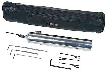

    I started doing it your way, but lacking a dremel I found it taking forever. The lower scissor part was very difficult to cut with a hacksaw, and I didn't have a diamond tip drill bit to go through the pick. So I just took some EPOXY PUTTY, and a needle from a snap gun - http://www.lockpicks.com/replacementneedles.aspx - and attached the needle to the upper part of the scissors, being careful to put it on the outside of the blade so as not to interfere with the motion. It works GREAT! And much simpler.
    0
    USMC sniper
    USMC sniper
    Reply 11 years ago on Introduction
    that bad boy cost about $170 depending on where you get it....sometimes you get lucky and find a used one for less...

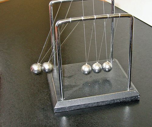

    Have you ever seen those hanging balls that people have sitting on their desks that bounce the outermost balls back and forth while the middle ones stay in place? It is the same principal that a quick tap will bounce the tumblers out of the barrel and allow the barrel to rotate in the lock.
    0
    lemonie
    lemonie
    Reply 13 years ago on Introduction
    Newton's cradle. But they'll also bounce back, and rotation is limited when they're not all in place. I don't doubt that it works, it's not so clear how (without the discussion) L
